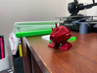

But I was talking with another woodworker last week about 3D printers in the woodshop and he remarked that he didn't want to "just be printing random stuff" which got me thinking on how I'm utilizing the printer for my woodworking. Sure, I've printed a series of Gridfinity inserts to "organize" my toolbox, doghole covers to stop parts and dust falling through the bench, Sliding Sys Rails, Systainer labels, tape roll dispensers, chisel holders, clamp holders, battery sleds, router rests, Domino Pez dispenser, MFT Hinge, rail angle guide and dust port adapters to fit a D27 to the RS2 - but has any of it really been FOR the effort of making a piece? It's mainly been workshop gadgetry stuff and a couple fun prints, like the Exocomp Peanut Hamper.

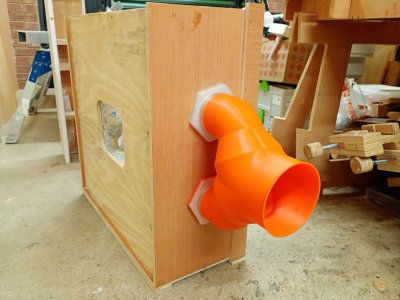

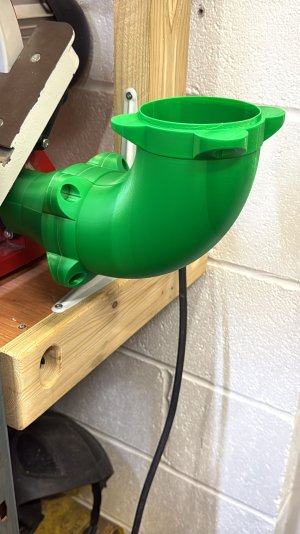

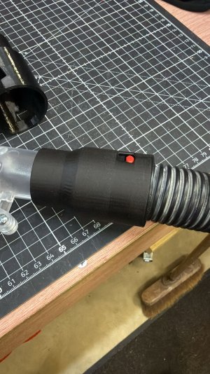

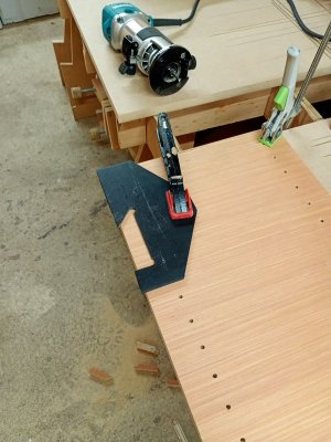

I use a 3d printer to make stuff when I can't. I can design a router template when I'm waiting for my kids somewhere, then print it overnight and use it the next day. I also regularly make vacuum adapters to connect tool A to vac B. I've 3rd printed at the tube fittings for my garage air filter.
Printing stuff is the easy bit, designing stuff is the hard bit.

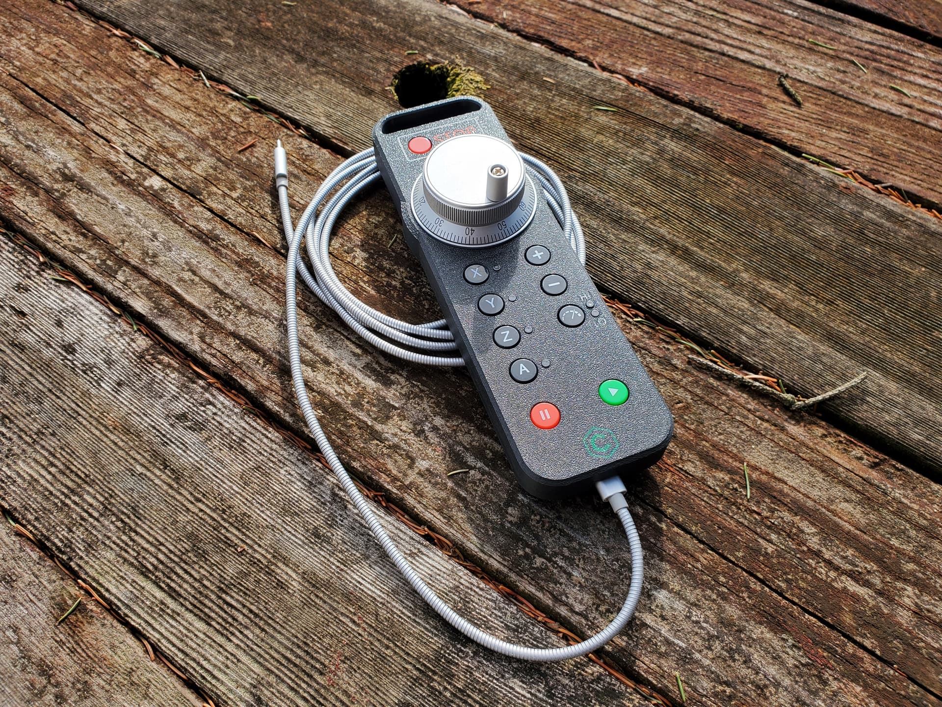

Oh, also, a Jog Pendant was recently added to our lineup by my employer:
and I 3D printed a slightly modified shell:
