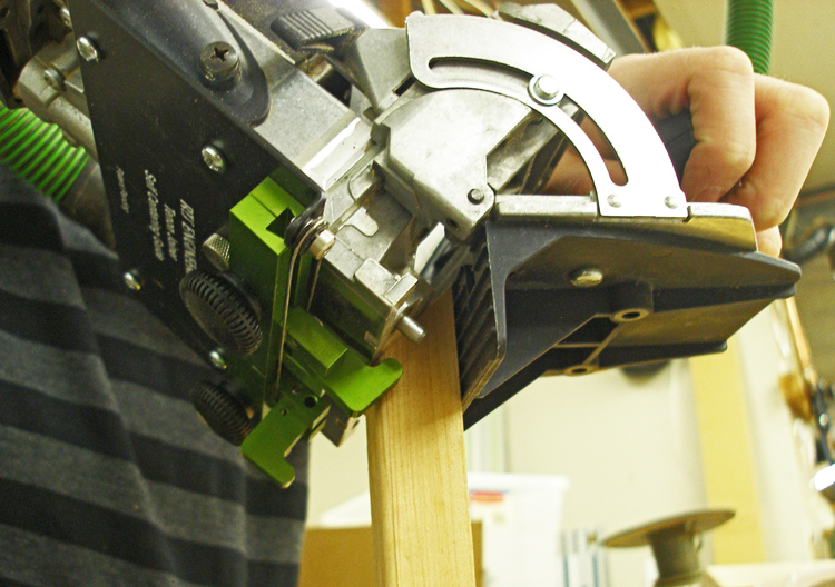

For positioning on the leg, you can just use the fence with the height set to the appropriate offset for the position of the apron. (The fence would register along the vertical edge of the leg.)
I would probably use the 6mm tenons. Make sure to position them as close to the inside (blunt) corner of the mitered apron boards as you possibly can. In the picture below, I show how you can use the base support mounted to the fence to register the Domino from the pointed edge of a miter. It does not require any permanent modification to your Domino, but I may have drilled a hole through the base support accessory (I can't recall if this hole already exists or not). You can see the head of the screw that goes through the base support and into the triangular hole that is already in the Domino fence face.
Unless you can offset your tenon locations, the opposing mortice locations in the leg pieces will intersect. So you may want to consider making a single through-mortice in the legs and use a single, long tenon to join both aprons and the leg.
