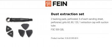

[member=65755]jarbroen[/member] Are you using this one for sanding?https://feintools-online.com/fein-a...ves/92602091000-fein-dust-extraction-set.html
FYI, That shroud does fit the OSC 18 with a pair of rubberbands and a handful of compromise.  The round part seats just fine once you have the delta pad holding it in place.  The tube (which is a separate piece) has clips that are meant to snap into detents on the current corded multimaster design (350Q and on).  There’s nothing to facilitate that connection on the osc18 so you need to devise a way to keep it from falling off.
Thanks [member=19475]yetihunter[/member] . Would you recommend another sanding attachment with dust extraction or is this the best fit despite the compromise.
The best that I know of.  There’s supposedly one for the recent corded Supercut but I’m not sure it actually exists.  I would imagine that the scenario would be the same regardless.  There’s nothing for the tube to mount to on the cordless units.

Quick update: I tried the Fein dust extraction kit today with the Festool Vecturo OSC 18. It fits but not optimal. (1) The attachment for the hose is very loose. (2) As others said it doesn't attach at the end. Both can be solved with some tape. (3) Another issue is that you can't use it with the big batteries or need to add another cushion. The vibration makes the hose damage the battery. I screwed that one but it's just cosmetic.
That’s partly on me.  While I do use the 6ah battery,  I only tried the dust fitment with the compact battery.
