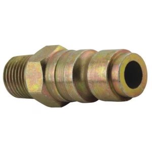

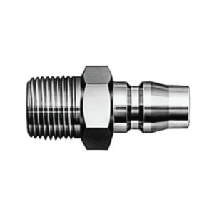

Pretty much all air gear sold here in Oz is with the Nitto fittings. Much better than the old style brass ones.

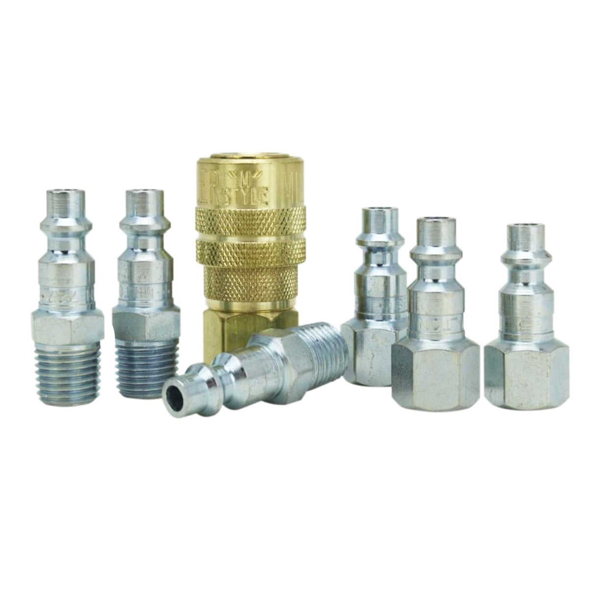

Milton 727 plug and coupler are probably the most common style in the US (M style). Most others are knock offs of this system.
Be careful with Nitto fittings, I have seen them disconnect when dragged over the floor, the coupling hitting a floor edge where it changed height and the collar sliding back and disconnecting leaving a manic hose going mad all over the workshop after it dinged a Mercedes side door. They can be had with release buttons but most don't use them for some reason.

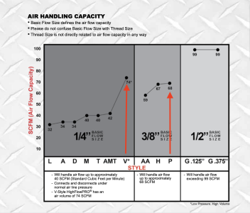

A long time ago I standardized on the Milton "P Style" fittings because of the high flow volume. At the time they were the highest flowing fitting and the size was still manageable. However, if I were to make the decision now, I'd gravitate towards the newer Milton "V Style" which is a hi-flow connector and physically a little bit smaller than the P version. The V Style is also the fitting used on the Festool VAC SYS and is a European interchange.

1/4" hoses don't flow enough air to run any tool except an air nailer or similar so keep that in mind though cordless tools have largely changed the need for pneumatic tools these days.
The Milton V-stye connectors are both compatible with the standard connectors, but if you have them on both male and female they're high flow. And you don't need to retract the collar to assemble, just to disassemble.

The Milton "M" style is by far the most common around here. Every place I have ever worked, including my home, have used that style. As mini me said, they are the restriction of the system. I have seen people use bigger hoses, but the fittings still hold them back.
Way back, in my mechanic days, they used the G type, with the shorter tip. That was the only way to get 3/4" or 1" drive impact wrenches to function properly. We still used the M style for smaller tools though, air-ratchets, etc.
Most homeowner/diy compressors don't flow enough CFM to make it worth changing.
Exactly. If you had a higher CFM pneumatic tool, you were generally using a 1/2" ID hose to feed it, and nipples and couplers that matched, or didn't restrict, the hose's ability to flow more air for the tool. Versus starving the tool with a standard 3/8" ID hose.
