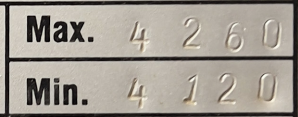

Actually, that sounds about right. My 540mm bandsaw takes blades from 4120mm to 4260mm, as stamped on the saw:
In Freedom units, that's a 21" bandsaw taking blades from 162.2" to 167.7" for a range of slightly over 5&½".
