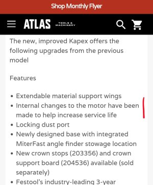

I suppose this is as close as you can get from Festool to acknowledge that some of its EB model saws may have an inherent problem.
The product descriptions for the Kapex 120 REB now mention the upgraded motors.
The honorable thing Festool can do is to offer EB owners a motor replacement service for free -- if the motor breaks down (Yeah, I know that's not gonna happen.)

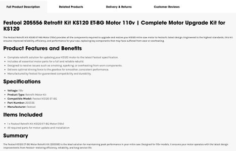

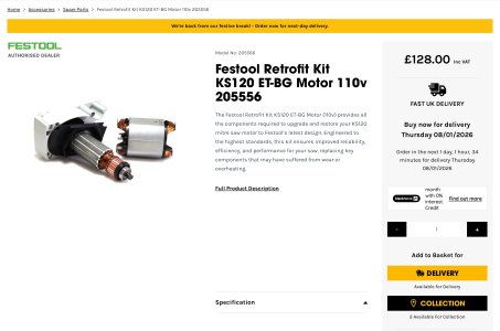

I purchased mine back in 2015 and it's worked flawlessly...View attachment 1769013139916.webp...however I'm also a realist and expect at some point I'll have to install the upgraded parts. The upgrade kits are sold in the UK as "just another commodity item".
If I remember correctly, the issue was metal/carbon dust collecting in the wrong areas and shorting out the armature. That would certainly be a Festool design problem from the get-go and I would think that replacement parts should be offered to original owners at a highly discounted rate. 🙏 🙏 🙏

This is why I've been very cautious about buying a certain era of used KS120. What I've gathered from the threads here on FOG is that the EB, mostly from 2015 onward, have the most (perhaps only?) issues with the armature.

I'd counter that statement with the caveat that if you perform the servicing yourself, and the replacement part costs $262, for a total of $1362 it still is a good deal providing the Kapex you purchase/service is in pristine condition. And while I'm sure there are some beaters out there, I suspect a majority of the used Kapex's are in pretty darn nice cosmetic condition. :unsure:
