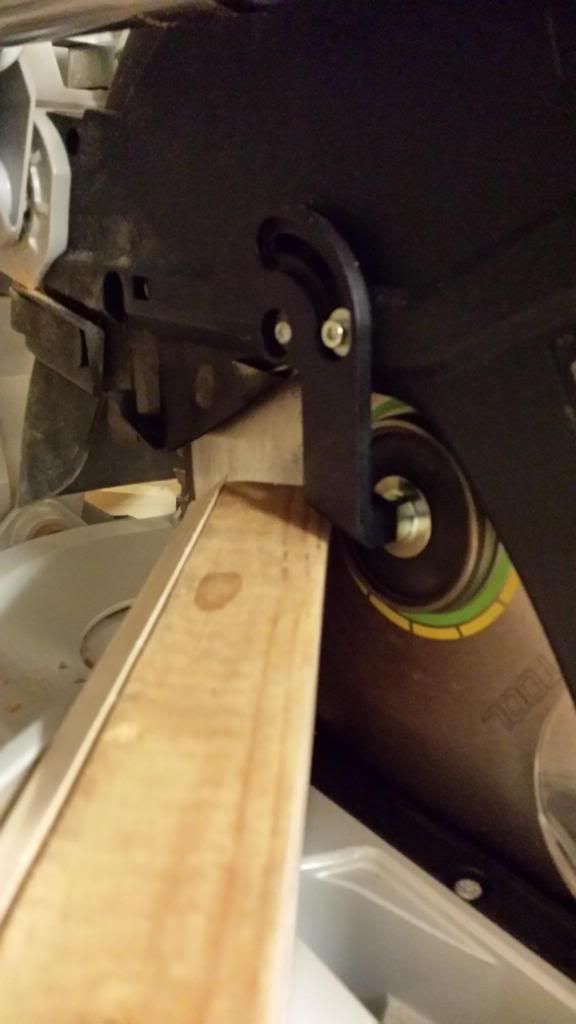

mastercabman: On my Kapex the arbor bolt guard ends up hitting my 4" x 1 7/8" lumber which prevents the saw from moving forward and completing the 45° miter cut when the lumber is standing up.  If I move the arbor bolt guard up then it actually hits the lumber earlier than when it is in the normal "down" position. Here is a picture with some "mock-up" lumber to simulate the lumber dimensions with the guard in its normal position to show you what I am talking about (sorry about the fact that the picture is rotated, for some reason this bulletin board auto-rotates this picture:
If I remove the arbor bolt guard then it is able to make the cut when the lumber is standing up...
So, at this point in time I am leaning towards making this cut with the lumber lying down with a 0° miter angle and a 45° bevel angle; this means that I will have to re-cut my story-sticks but it beats having to removing safety mechanisms...

Safety is your top priority but for info my new Kapex bought here in the UK 8 weeks ago doesn't come with Arbor Bolt Guard!
I assume that there our Arbor bolt remains unguarded for a reason.
See photo below.
See photo below.
Hmmmm.... Very interesting... Perhaps Shane, or someone else more knowledgeable than I, could chime in here about the intended purpose of the arbor bolt guard that appears to be present on units sold in the USA and as shown on the cover of the Festool USA Kapex Supplemental Manual found here: http://www.festoolusa.com/media/pdf/kapex-ks120-supplemental-manual.pdf

The arbor bolt guard is a unique requirement for the US market as I recall. We do not advocate removing/modifying/overriding any safety component of our tools for obvious reasons.
Edit to expand: I guess UL thinks Americans are dumb enough to try to remove the blade while the saw is in operation...

Well that's because the saw is not designed to cut that size

Earlier on this thread I stated that I called Festool USA before purchasing the Kapex to ask about this and they stated that I would be able to make that cut...
My experience has shown that I am able to make this cut with the lumber standing up, but only if I physically remove the arbor bolt guard; perhaps I should have purchased my Kapex outside of the USA since it appears that only units sold in the USA have the arbor bolt guard...  [blink]
