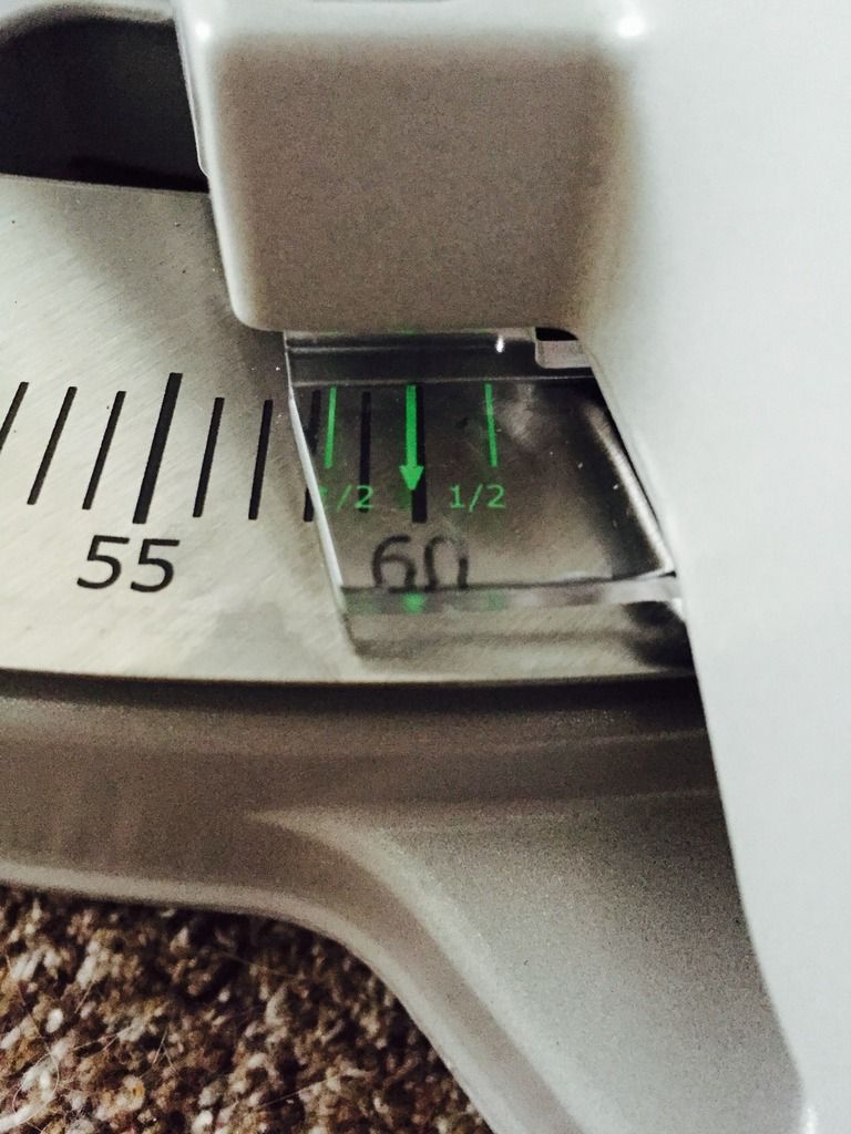

Right, so I received my New Kapex on Thursday after my Metabo let me down as i'm right in the middle of a job and couldn't be without a mitre saw, i've read loads of reviews and people seem to talk very highly of the accuracy straight out of the box however this doesn't seem to be the case with the one I've received, i haven't used it yet but could anyone please tell me if this is normal or whether i should be getting in contact with Festool as for a little over £800 this is one of if not the most expensive saw on the market so i was hoping that it was going to be calibrated perfectly, Thanks Jack

Only issues I had with mine was making sure there was a outlet close enough to plug it into and getting 2 meter 35mm hose to use gives ya better dust collection when using a CT
Welcome Jackofall.
    If it was me I would download the supplementary manual and have a read through that first. I would then start to make some cuts to see what needs to be adjusted. Good luck.
Page 24 and on of the Supplemental Manual show a way to test the trueness of the Kapex and how to make any necessary adjustments.
Remember to let the blade come to a complete stop before lifting the saw's head. If you don't, the saw can launch the cut off with great violence.
Jack,welcome to the FOG.  I'd suggest you use the saw on your current job to find out if it is cutting accurately or not.  If it turns out the saw needs calibrating I wouldn't adjust it, I'd send it back.  The calibration process can be very finicky, and I wouldn't go through that on a brand new saw with the this kind of price tag.  I believe in the UK you have 15 days to try Festool tools out.  Good luck.
Thank you everyone for your help, think i will take it to site next week and have a little play and see how its cutting, just thought it was odd that the green mark lines up perfectly on the left hand side of the saw but not the right, won't know for sure until i start using it though but thanks for all the advice :)
My kapex needed adjusting when it turned up, should have sent it back but needed to use it so did it myself, was very fiddley.
Doug
