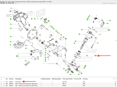

I just checked and the End Shield costs $277, so if the saw functions now and then goes puff, you'll only have $777 invested in an $1800 saw and a $170 blade. That seems like a reasonable trade-off to me.

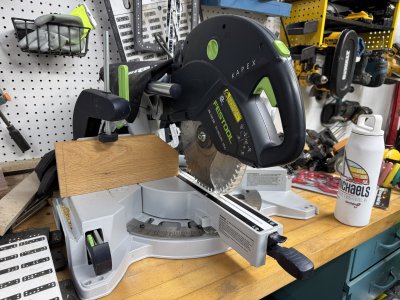

Thank you all. And here it is: the Kapex KS 120 EB!
However, it is not mine.
I messaged the seller pretty soon after I saw the listing but never heard back. My good friend messages me in the morning: “Have you seen this?” And I said that I messaged the seller and waiting to hear back.
My friend messages back: “he called and I’m going to look at it today.” So off we went to see the saw.
Turns out it was built September 2009 so well before the era of armature issues. Owned by a furniture maker who does most his work by hand, it had been well cared for, very clean and in great condition. He’s the kind of user you want to buy used from.
We checked it out, hung out, shot the shit and had a great time. $500 for the KS120 including the extra 80T blade (both recently resharpened) and all the proper stock accessories. I think a solid deal and a seller easy to work with.
