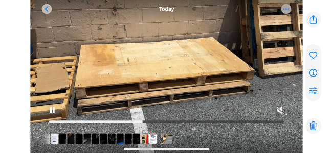

You might consider me a charlatan for this, but for my shop projects, carts and cabinets, I've been turning to salvaging wood. Like this plywood pallet from Harbor Freight. Looks to be about 3/4" thick and in reasonable shape. I tear the pallets apart and then make the cabinet out of them. In this case, I'm going to use this ply to make the carcass for my oscillating spindle sander which will also have some amount of systainer storage with SYS RAILS.
