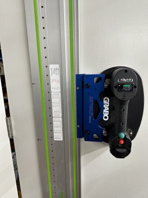

The Festool rail with the Grabo is the charm. The on-board vacuum monitoring takes it to the next level. Before the Grabo existed the Gecko was the only solution. It's still a solution but only for some less dynamic applications. I purchased the Betterley Grabo adapter and am very satisfied. Here's a Festool rail mounted vertically on a door.

@Cheese Do you use 2 Grabo's or one? If one, do you get any pivoting movement in use?
Just one right now...I didn't know how handy this thing would be until I put it to use. However, there's another one in my future. :) I don't get any pivoting but if this was a super critical cut, I'd definitely use 2 of them...belt & suspenders. It all depends upon the distance spanned. For a 32" wide door trim I'm sure one will suffice, for longer distances, it's called insurance.
