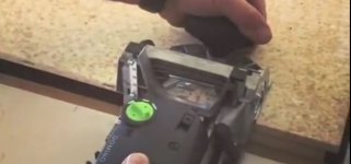

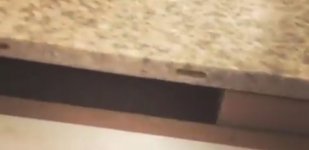

The Domino machine can even be used to cut non-wood materials such as granite (?) countertops.
