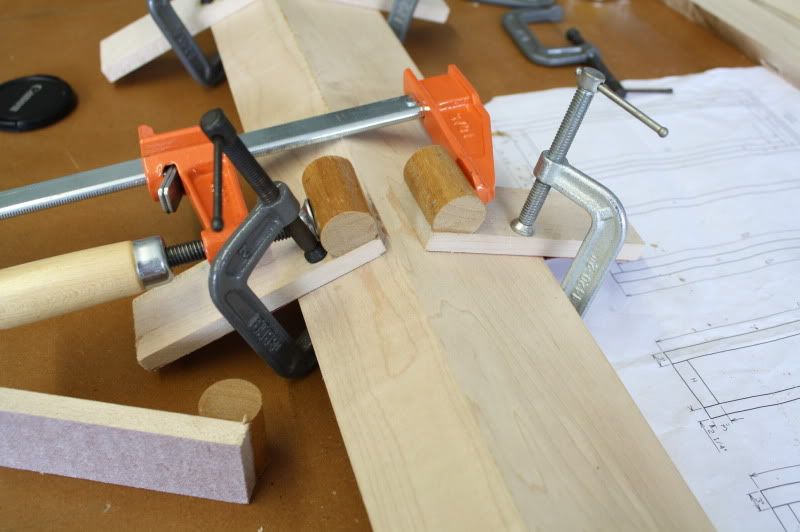

Home made (not mine)

Those with the round section (looks like a piece of handrail?) are ingenious in the way they allow other than just 90 degree miters. I've made the type shown in your photo, but now I'm gonna make a set with the round clamp pads--thanks for posting. BTW, the grip can be enhanced by sticking on a piece of self-stick sandpaper to surface that touches the work.
The round stock in the small picture is 1" dowel stock, with one flattened side, glued to scrap.
