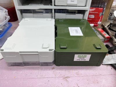

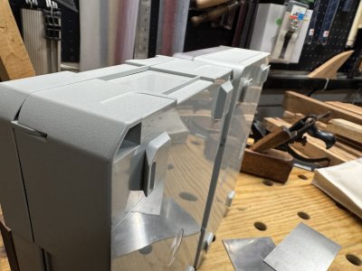

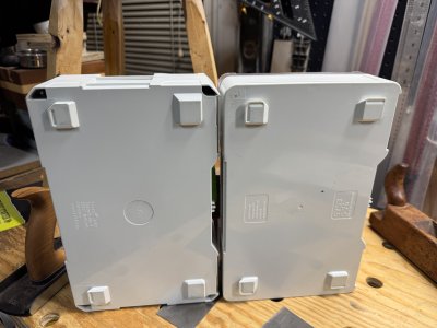

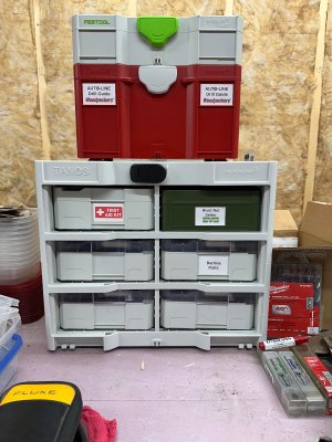

As @jronman mentioned, if used as a stationary storage rack, the older MINI-Systainer T-LOC fit in and LIGHTLY locked-in. I'm sure for mobile applications it won't be optimum, but for stationary storage it's fine.
I know this is an older post but has anyone had any luck doing this? The link above is dead :(

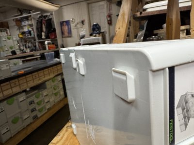

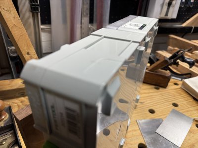

I don't have the rack, so I haven't had the need to do the mods. But looking at Cheese's pics and these pics, you can see that the feet are different. If you were to modify the T-Loc feet to match the notch, then the T-Loc should lock into the rack.
I think others have used a Dremel with cutting wheel but have also experienced melting, so you'll want to watch the speed and length of time the wheel is on the plastic. Or perhaps cut the feet off entirely and 3D print new feet?
