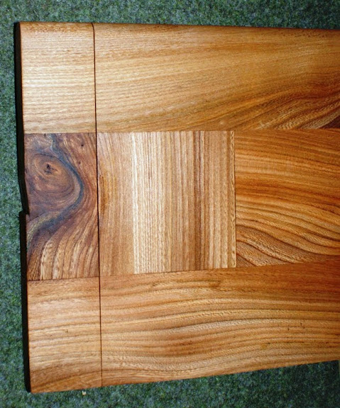

Following on from the vanity top the clients son found another bit of Elm, so while keeping in mind my coopered vanity unit and door idea I found that we have (fingers crossed) enough to do the top that will sit over the concealed cistern for the W.C.
The design required a bit of cunning use of the Elm and some offcuts plus everyones friend the "Domino" ;D
The result is a top that can be removed by sliding forward and lifting so no unsightly screws or pellets.
Yeah! yeah! you lot want some pics too.
The complete top, the sign is my first attempt at letter carving for a friends present..

The side pieces will be screw fixed to the frame of the boxing that hides the plumbing and cistern.
