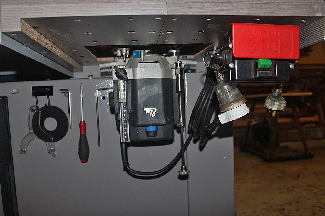

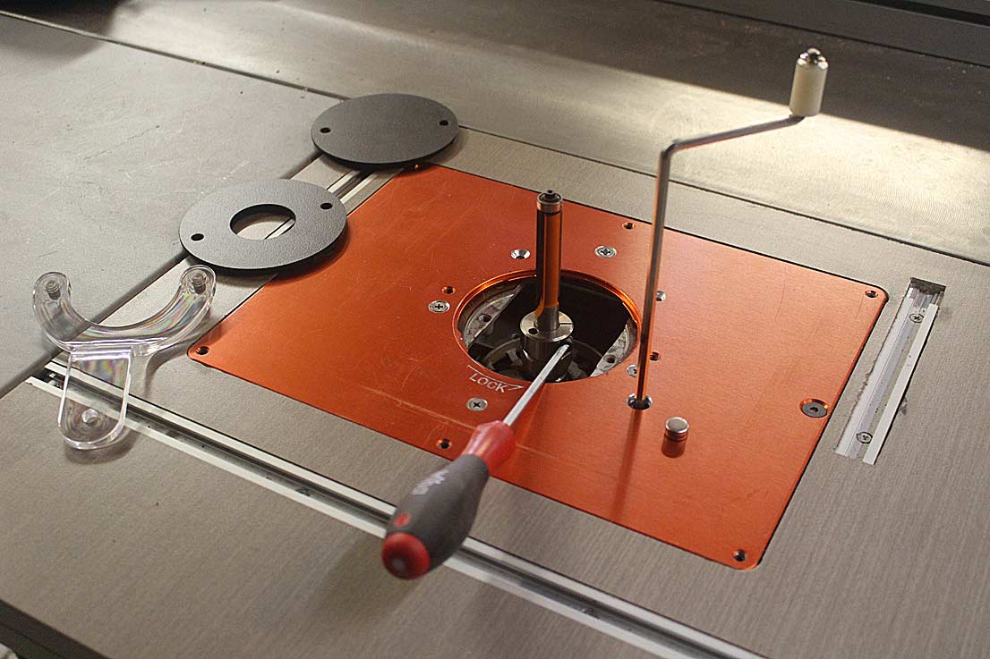

I do not have a problem using the standard MuscleChuck in my router table (with Router Raizer) ...
It is reachable even when the chuck is not raised completely ..
The router is an Elu 177e, which is the forerunner of the DeWalt 625 ...
Handles removed, and attached to the outfeed of a Hammer K3 on a basic aluminium plate ...
