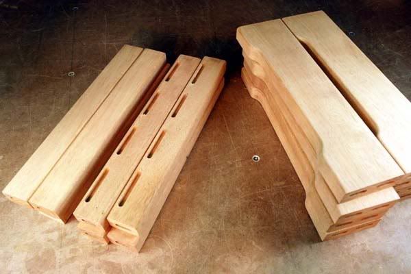

Here are some Greene and Greene legs right out of Darrell Peart's Book, Greene & Greene Design Elements for the Workshop
I really love the look of the detents on the foot
Made the thickness of the legs at 1 3/8ths - a little lighter look than 1 1/2" but still stout for these small tables.
These are Made of Genuine Mahogany with false Gabon Ebony plugs. They are not pillowed or proud. Maybe next time, when I want to truly replicate the authentic style.
The design of these side tables is meant to have some G & G features but with a slight modern twist. The plugs are sanded flush and were cut using a 1/4" mortise bit, at a depth of about 1/4"
The legs are 24 3/4" tall 625mm and 1 3/8" thick - 35mm
The leg detents were made using this jig.
The aprons were pattern cut using this jig. The parts were cut using a routher table with the top bearing bit.
Here are the aprons and lower rails with stopped dados in them to receive the slats that were almost waste as my original design called for an open lower area with no shelving. In the spirit of Nahman I used the scrap cutoffs from the milling of the 8/4" leg stock.
And here is a couple of pics of the dry fit
The top will not be the bread board with proud ebony spline, but will be of a more contemporary style that I hope will blend nicely withe the G & G elements shown so far.
The tops will be the premier feature on the tables. I have something special planned that I hope will take the design to a fresh level but yet complimentary to the style of arts and crafts.
The size of the tables are 14" square - 355mm without the tops.
Tools used so far:
SS cabinet saw
Grizzly G0586 8" jointer
Powermatic 15S Planer
Performax 22 44
Grizzly G0563 OSC Edge sander
Grizzly 513 17" band saw
Powermatic 701 Bench Top mortise machine
Jessem XL router table
Porter cable 310 router
Porter cable 5" Quick sand ROS
Tormek Sharpening system-jointer blades, chisels,hand planes
MFT
TS55
Domino
And that's just about my entire arsenal of tools
These parts are ready for final sanding and glue up.
Tops are almost done , they have some inlay and spline work.
Finish will be Target garnet shelac sealer and then USL.
