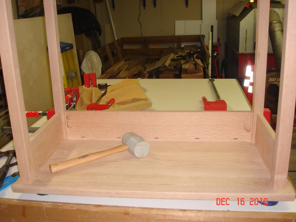

It's also perfect for registering recesses for Z-clip table top fasteners:

Actually no. I figured out how to do it long before I bought Ron's Domiplate.
I set the fence height at 28 mm.
I wrote down my setting on a piece of tape, and stuck it to the inside of the Domino systainer lid.
[wink]
Edit to add: I checked my setting, after originally recalling perhaps 20 mm, but it was actually 28 mm.
I edited the post to reflect the correct setting.
(Realize that the 28 mm setting refers to nominal stock width, so the actual dimension to the center of the slot is 14 mm from the top edge.)
Hope that helps.
