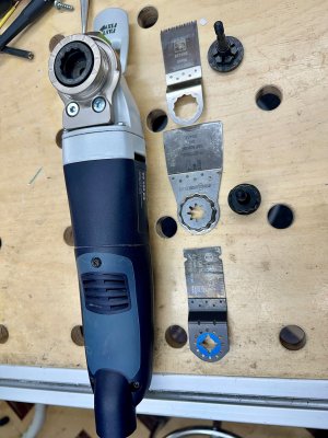

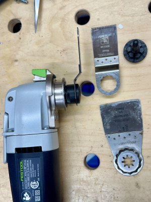

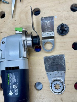

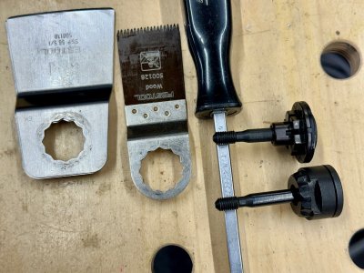

Here are some photos of the OS 400 and the blades that will work on it with the Fein adapter.
1st photo: You can use standard Supercut blades, Starlock Plus blades and OIS blades.
2nd & 3rd photos: Notice the amount of offset the adapter introduces to the Vecturo, that may or may not be an issue depending on what you're doing.
4th photo: This is the Quickin mount for the standard OS 400 and for the Fein adapter.

The offset would render the plunge useless but the ability to use starlock blades would be 100% worth it! If i were to use it without the adapter, which specific blade types would i need? I know festool is unique so would like to purchase the correct ones to use with the plunge attachment.
