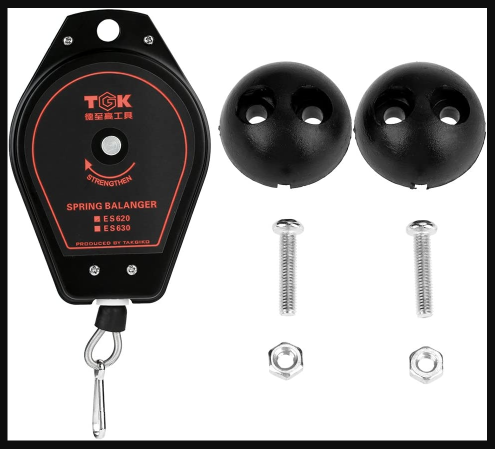

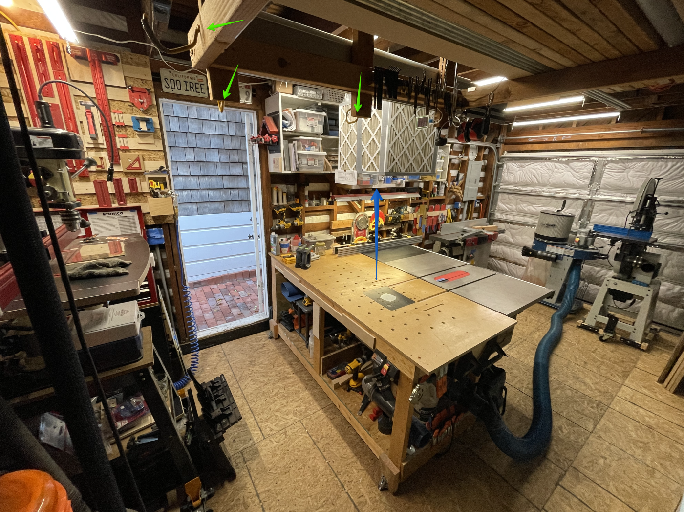

My assembly table is also my outfeed table and I typically stand in one spot while sanding, using the Domino, etc. Thanks to [member=57948]ChuckS[/member] suggestion, I was able to find a spring balancer that should work. I'll relocate my box fan air filter and put the balancer on one of the joists above the table. Depending on what I'm doing, I can route the hose to the balancer from either side.
I currently hang the hose over various hooks (green arrows) that are off to the side and behind the table. Sometimes it works, but most of the time I'm fighting with the hose and adjusting slack. Also, the hose won't be permanently attached to the balancer. I'll clip it in as needed.
I like the idea of using the balancer with a rail system. Once I try the single point, if it doesn't work as well as I was hoping, I'll look into adding a drapery rail or maybe the Rockler track to offer more flexibility.

This is the balancer I ordered. I hung it from a joist tonight and attached the hose to it. It arrived too late in the day to do any actual work, but walking it around the workbench and testing the retraction, I think it'll meet my needs rather well.
https://www.amazon.com/dp/B07GYS4RSH?psc=1&ref=ppx_yo2ov_dt_b_product_details

The tension is adjusted via a dial on the back of the balancer. Once you set it, it should remain at that tension. When I first pulled it out of the box, I thought the minimum tension was going to be way too strong. I was definitely wrong. I dialed it up maybe 4 or 5 times -- there's maybe 1, 1-1/2 turns left -- and it seems to be perfect. I'm using a Rockler Flexiport Hose and it's a bit heavier than the hose that came with my Fein Turbo.
Knowing what I know now, I'd probably get something with slightly higher tension, maybe 1.5kg - 3kg.
That's good to know. My hose is probably somewhat heavier than yours - its an older 3.5m version of this one from Festoolhttps://www.festoolusa.com/accessory/201761---d2722x5m-as-gq-usct#Overview and I might be ordering the 5m one if my current one is too short for the new routing.
Based on that, I'm thinking of ordering this one:https://www.amazon.com/QWORK-Spring-Balancer-1-1lbs-Assembly-line/dp/B0952QYP1W/ref=sr_1_1_sspa. It's a 3.3lbs - 6.6lbs unit (1.5 - 3kg). They also have a 6.6-11LB (3-5 kg) version but that might have too much tension for the application. They're cheap enough that I can experiment.
