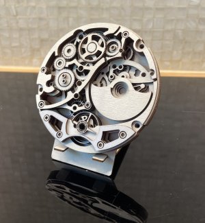

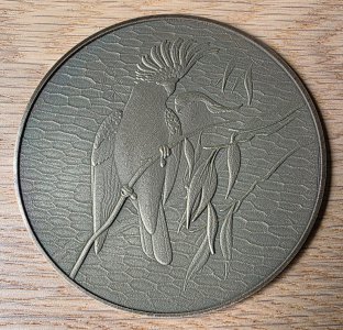

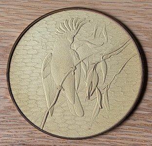

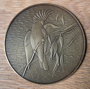

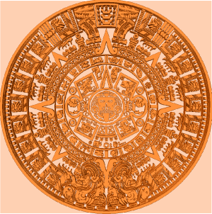

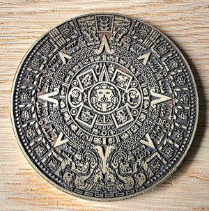

Here I've created a brass insert to go in the top of a turned box. The first lot of pics are of an 80mm x 2mm brass blank, engraved with a depth map converted from an STL I created from 2 models. Run time was around 5 hours, I'll put up the parameters if anyone's interested.
I'm very happy with the result, when brass is engraved with a fiber laser it ends up a washed out beige kind of colour that's not at all pleasant as can be seen in the first pic. In the 2nd pic I've applied some brass and copper antiquing solution, which will turn it from light brown to almost black depending on the dilution. The 3rd pic is after having buffed it with a 1500g woven pad. At this stage the results really start to stand out, but it still looks a little "flat" or lacklustre. The 4th pic is after I've buffed some Odie's oil into it. This gives a really nice tone and vastly improves the appearance, while leaving the surface dry to the touch.

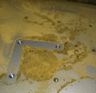

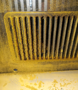

For the F2 60W fiber laser I have (didn't get the blue diode option), the dust waste from brass is voluminous, and superfine, and despite it not billowing around as you'd think, it still seems to get into everything within the vicinity of the machine. Attached are some pics of the rear vent, and the base showing the massive accumulation of brass waste. I ended up not hooking up a filter to the default built-in fan, and instead removed the built-in fan, and connected a much larger pass-through fan with larger 3.5" ducting, with the output a couple metres away near the garage door, pointing into a bucket of water.
It's weird, the brass dust doesn't float or become air borne, it just sort of sits there and accumulates, with the stuff closest to the extractor being sucked out.
Any thoughts I had of putting this machine in my study are absolutely out of the question. I don't think there's any amount of dust extraction you could provide that would make it something that could go in a house. Certainly not when mainly doing metal as I do.

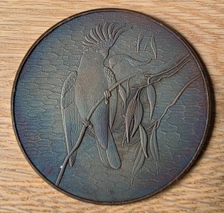

This is really quite interesting, thanks for taking the time to educate us. I find your brass medallion processing steps particularly interesting as after the initial embossing, all of the next steps taken, had nothing to do with additional laser steps, only different finishing steps/techniques. I wonder what hitting step #4 with some fine ScotchBrite would produce?
I like the idea of lasering router templates rather than machining router templates.That should be quicker to produce.
@Cheese The Odie's oil was buffed on using a very fine pad similar to ScotchBrite, my finishing coats are always done this way even when I use Danish Oil, gives superb results.
Sounds weird but after the tarnishing and initial buffing, the oil really brings out the detail on the brass and gives it a nice matt lustre. Even a kitchen vegetable oil would work the same here.

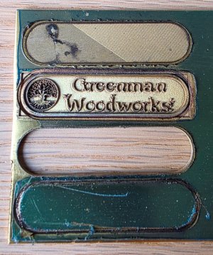

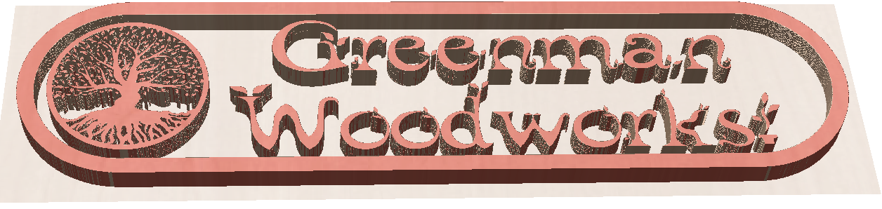

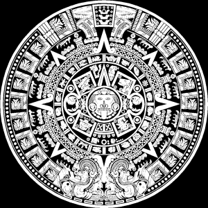

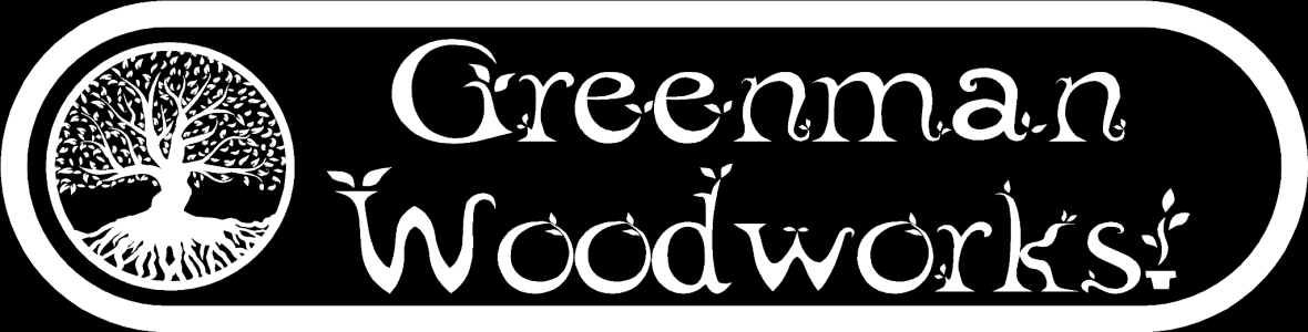

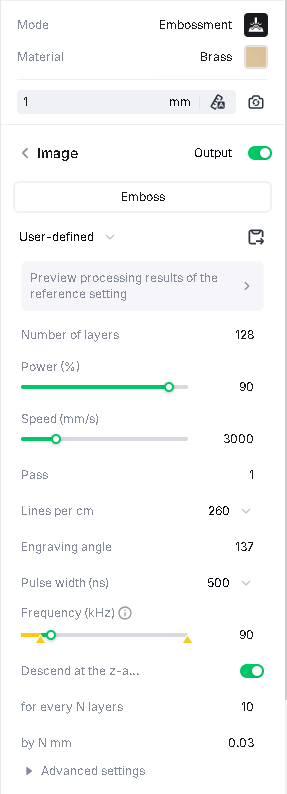

Converting 3D STL's to a 2 level Depth Map & 2.5D Lasering
To emboss a logo in brass, I first create a 3D model and save it as an STL as seen by the first screenshot pic. I find I get better results with the detail on the depth maps if the original model is around 10-15 times actual size with the height 20 times actual size.
I then upload the model to "STL2PNG Converter" https://fenrus75.github.io/FenrusCNCtools/javascript/stl2png.html and generate a depth map as seen by the 2nd pic.
As I want the top surface flat, the depth map only has 2 height levels, which will cut down lasering times a little.

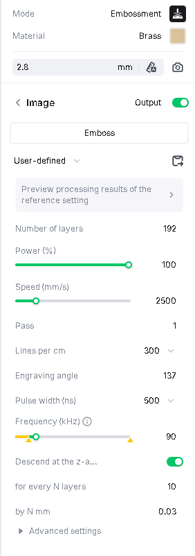

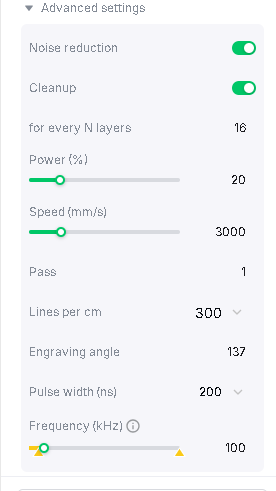

The result comes out very crisp and clean, and the settings selected as shown by the 3rd pic work out about 0.5mm depth in 1mm thick brass, each logo taking around 1 hour, but this time can be tweaked further to reduce it to probably around 25-30 minutes per logo. I think with this 60W laser 25 minutes is about the minimum achievable to still have a worthwhile result.
