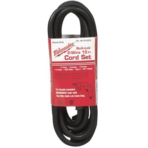

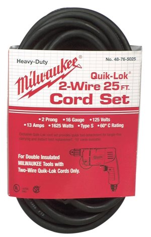

Milwaukee offered that option for years. The cords were available in 10' lengths for bench work and 25' lengths for on-site work. Unfortunately, they currently only offer a couple of drills and a circular saw with that option. Back in the day, most of their tools had that as an option except for vacs & mag drills.
  • 48-76-5010 Quik-Lok® 10' x 2C, 16ga:13A .jpeg
  • 48-76-5025 Quik-Lok® 25' x 2C, 16ga:13A.jpeg

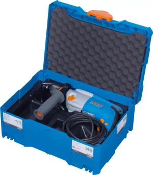

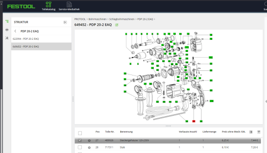

Check out Protool PDP series drills .. you can still "make one" if you buy the Narex descendent EV/EVP series /same thing, different color/ + swap-in in the relevant Protool connector.
Go protool.de -> parts catalogue .. pictured drawings over there.
The long story:
TTS closed shop on the Protool, brand in 2014 because it did not sell ... enough. Sure, PlugIt IS great. I have an angle grinder as well as drills with it ... BUT. One needs to understand its benefits ... and too few did/do so even today with all the Youtubes of the world.
Just another case where TTS/Festool/TANOS really REALLY fails in educating the general customer public about the capabilities their tools possess ... they truly do an utterly disastrous job at it.
On the other hand, frequently disconnected plug-it cords get loose in the tool end connection and they are responsible for tool end shorts that sometimes require plug-it socket replacement, or worse.
You have to be vigilant to signs of loose connection and and shorting to be able to replace the cord before serious damage occurs.
The connector costs $5$10 to replace .. easy-peasy. Most tool-end connectors are even identical, so it is practical to carry a spare along on site as the same part will fit most tools.
Compare that to fixing broken fixed cable /a VERY common issue with non-plug-it tools/ where one has to crimp it properly with specialist tool while shortening the cable ... way easier to just swap the PlugIt part.
@friedchicken
1) get this one:
It is a "post Protool" Protool PDP 20-2.
2) The get the connector - Protool spare #489926
/available through Festool as a spare part, I think related Festool spare will be the same thing, just not sure the Festool #/
