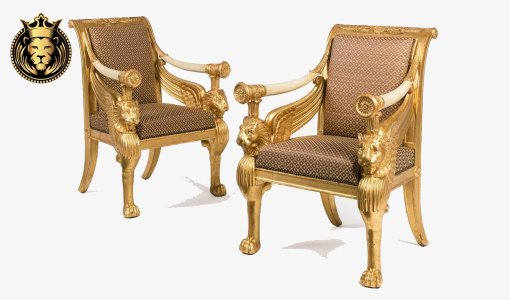

No stone versions. And no gold leafed arm rests. 😁
Oops! I spoke too soon (though the actual “rest” portion seems to be fabric.):
Very nice dining room chairs you have there Packard! ;-)
I'm surprised you didn't compliment Packard on the wonderful job he did on the gold leaf on those chairs.
Whoa...just noticed the tusk arms...perfect for the Kennedy/Trump center, especially for extended performances. :ROFLMAO:
