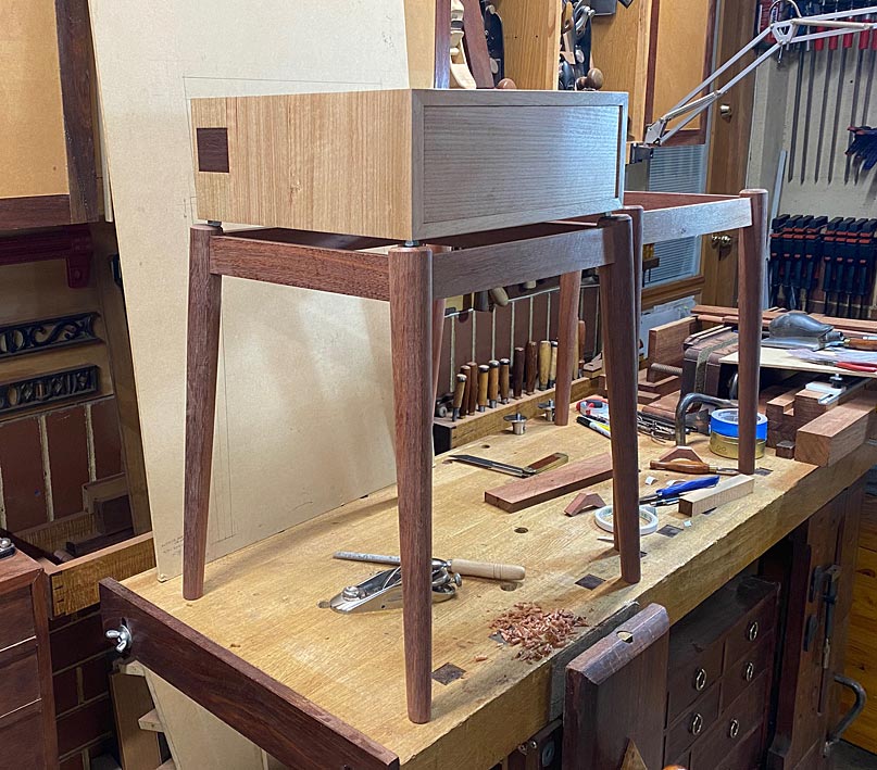

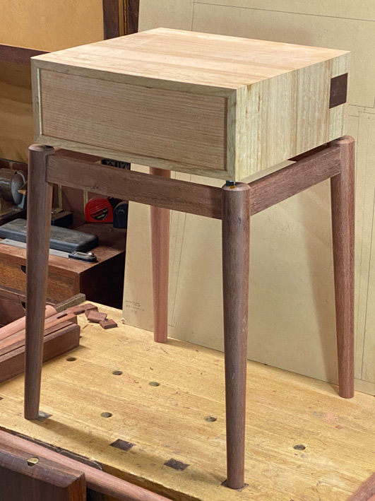

Last time the nightstand build ended with a mock up of one nightstand ..
Here steel nuts were used to lift the cabinet off the base. This weekend I completed the second base. Here are the two with the cabinets resting on the bases ...

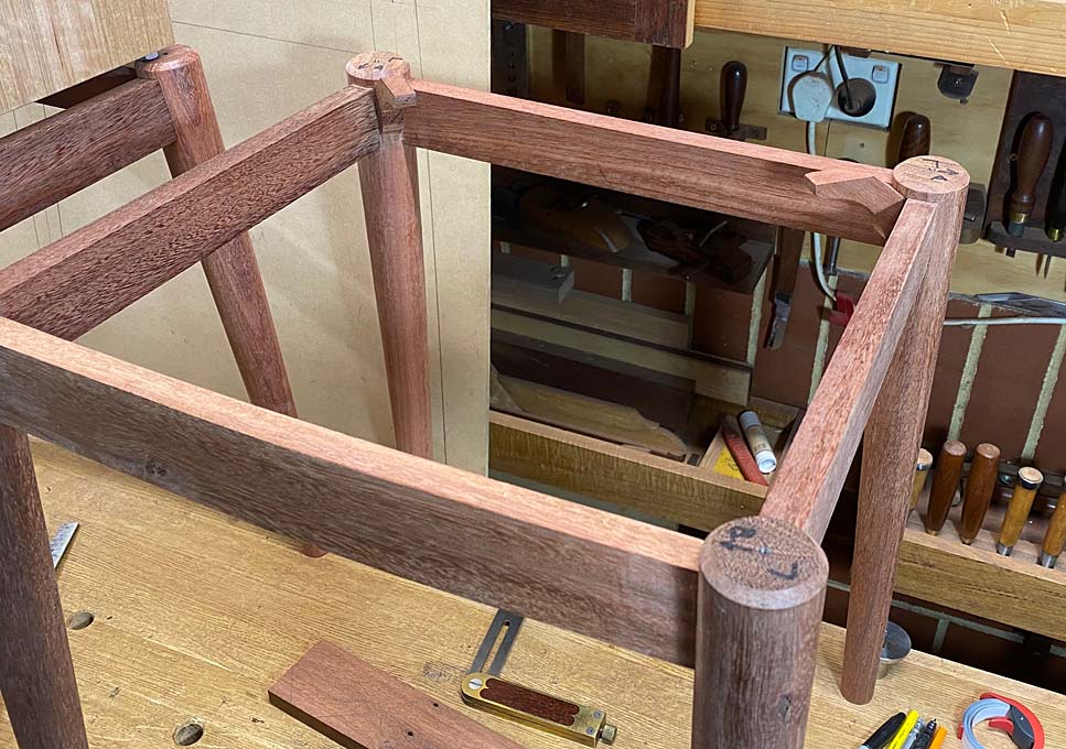

I had been planning to construct the floating appearance by using a slight variation of this construction ...
... but the example with the nuts had me thinking if there was another way, one less observable from the side.
Here is a mock up again, taken today ...

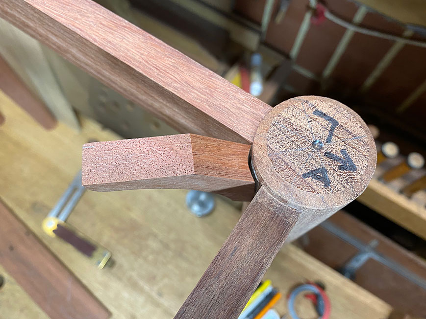

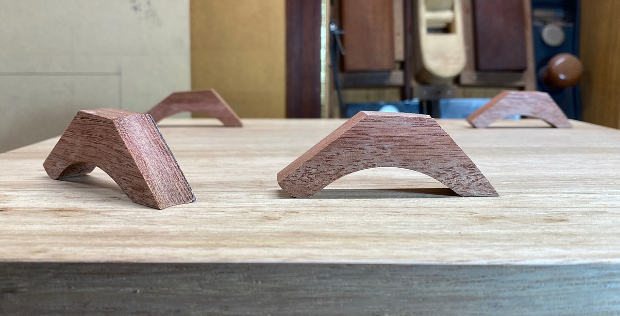

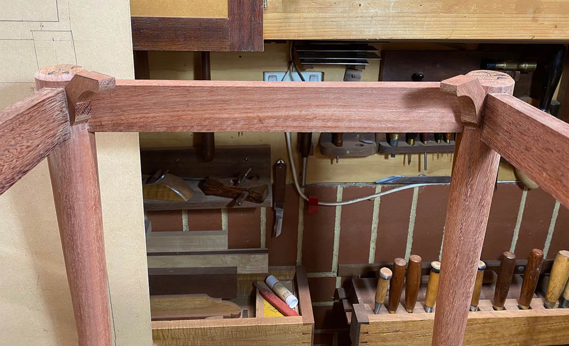

I came up with this linkage, and what I am after is some opinion as to how secure you imagine it will be.
These simply began as Jarrah triangles, and were shaped to reduce unnecessary bulk (which might be visible). All legs are 10mm thick x 18mm wide ...
For greatest strength, the grain runs across the bracket.
The one side was coped to fit flush with the round leg ...
This is how it is intended to be fitted ...
Here is the mating of the coped inside with the outside of the round leg ...
The plan is to glue and screw the coped side. The glue joint should create a strong connection, and a screw will just provide extra support. The cabinets will be screwed to the top of the bracket.
Opinions and ideas?
Love all the details on these, from the subtle curves, to the splayed legs, and the beautiful dovetails. This is truly fine woodworking and craftsmanship to aspire to.
If you want more visual separation between the corner of the box and the top of the legs consider rotating the brackets 180 degrees in the Z axis, then 90* in the Y or X.
In your last pics the bracket goes up, then in at 45*, then over to get deeper under the box.
Instead, let the bracket go in, then up to get under the box. The simplest shape of this bracket is 1/4 of a ring but you’ll probably want to customize it.
It might look less strong but it really isn’t, especially after all the screws are secured. The box still rests on four screws in sheer at/in the legs.
[member=4358]derekcohen[/member] That looks really good. I like the design overall and this new modification too.
Though I probably would have gone the lazy route and routed the inside of the legs flat, rather than rounding the inside edge of the brackets.
CRG, it is actually easier to cope the ends - just use a rasp to do this.
