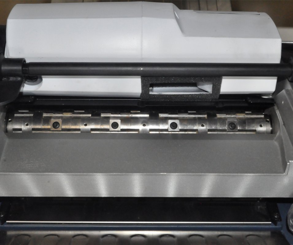

I would like to know if it is a true helical head. From the manual, it looks more like it is segmented, not helical

I have a dw735 with a Shelix cutterhead.  Looking at the specs for the Rikon there are a couple of things that jump out at me
1) the Rikon uses HSS cutters and the Shelix are Carbide
2) the cutters on the Rikon are only 2 sided while the Shelix cutters are 4 sided.
Based on the above youl will get much more life out of the cutter on the Shelix head than you will out of the cutters installed in the Rikon. This at least accounts for part of the difference between the 2 units

Good eyeball...that's a huge difference. Why would they even bother using HSS inserts? And then 2-sided on top of that [eek]. Small carbide inserts are usually in the $3-$4 range and with 40-50 inserts per unit you've got a couple of hundred dollars just in inserts.
I recently started looking into this again and found that the Rikon is not a spiral cutter.  It is just flat with 26 inserts.  Not sure you get any added benefit (noise, cut, etc.) for that setup.

Hey [member=13058]Kev[/member]
Here is a picture I found of the cutter head.
http://www.highlandwoodworking.com/productimages/stationarytools/Rikon/191167-2d.jpg
On this particular model, i didnt like the layout plus the fact that it had only 2 sides to rotate through as well as they were not carbide.  For 550.00 USD, I would rather put that money elsewhere.  A DW735 with Shelix cutter would put me in at 2x that cost so I might as well look at Jet and other combo machines.  If I am spending THAT much, I might as well look at a Hammer... strike that... a Felder!
