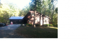

1x6 Tongue & Groove. I agree it's definitely a big job but much cheaper than replacing the siding and much safer than chemically stripping it. I'm hesitant to go with a bigger sander due to the fact the siding is around 35 years old and does have some cupping. I also really liked the versatility of the RO90 and hoped it would work well into the "V" groove sections. Although not the best, attached is a picture showing the front of the house.

I've gone back and forth on the idea of using a chemical stripper, but I would rather avoid them if possible. I'm guesstimating that if I could handle one section of the house at a time per weekend, I could complete the house by the end of the summer. I've attached some closer pictures. I only applied one coat of the dark stain. I'm more disappointed in the blotchy appearance than I am in the overall color. Although, once I completed the staining I instantly wasn't a fan of the dark brown roof with the dark siding. I'll admit it was my staining skills or lack there of that lead to the blotchy condition. I've attached a close up shot.
