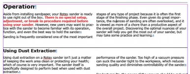

There is no break-in period required for the sanders. How do I know? Because it specifically says so right in the manual!!  [big grin] [big grin]
Seriously though, I have examined the sanders in ways that regular users cannot afford to do. There is no need or benefit to performing a break-in. Some have said, "It can't hurt." Well it does hurt. It needlessly puts 8 hours of wear on a brand new tool for absolutely no purpose.
