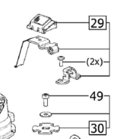

Thanks Alex. I just took it apart. I see the parts around the switch are not too expensive and are easy to remove/replace, but I can't really see if something is worn or not. Not sure if it's just the switch mechanism which has become loose/warn or perhaps something in the gearbox or elsewhere is providing too much resistance and that is causing the switch to pop out of rotary mode.
Finally. I ordered both parts in the image linked above, #29 & #30. It was hard to tell which was the culprit, maybe it was the combination of both. The old parts seemed very slightly worn compared to the new ones. With the new parts, the problem has vanished. It took a long time for me to confirm because of course, the brushes gave out right after the repair, so I had to order those too. Thanks to everyone for the advice.
