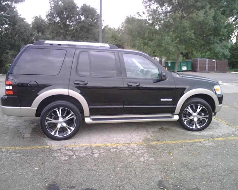

Here's my $0.02 on using a clay bar. If your car hasn't been detailed in years, you will either be very pleased or very disappointed with the results of taking a clay bar to it. In some cases, a tough to wash away layer of dirt actually helps to hide paint imperfections. Take a car that's been used for highway driving but not detailed in years and that clay bar may reveal a paint job you'd like to hide again. 18-wheelers are notorious for throwing up things on passing cars (like brake dust and axle grease) that can really destroy a paint job over time. I used to own a very well-maintained 2000 Ford Explorer that people routinely said "looked like new" but I knew every imperfection in its hood and let me tell you, hoods take a beating from both the elements and the heat of the engine. My big fear with any automobile is maintaining the paint so as to avoid even the most remote chance of delamination. I get shivers up my spine whenever I see a car go by that is in any phase of losing its paint.
There's really no substitute for constant detailing of an automobile. Find a reliable care place and pay the $20 or $30 to get a good hand-washing and wax every few weeks and you'll never have the horrible afternoon experience of finding out that not only can a 'spot' not be removed with a clay bar but actually looks worse when the surrounding area is cleaner. Also, if you're going to use a clay bar, make sure you have the time to apply a good amount of wax to that vehicle right after. Clay really cleans a car but also leaves it vulnerable as well, especially older rides with various degrees of clear coat protection.
This is my new love affair and I wouldn't let her go more than 2 weeks without a good hand-washing and waxing:
