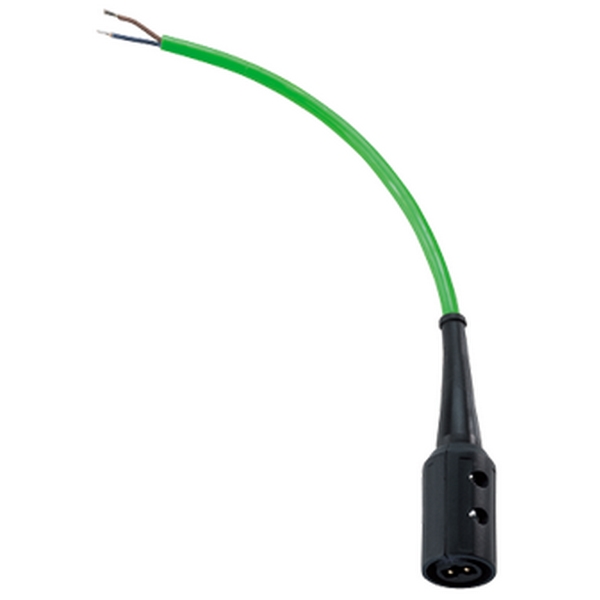

Had an RS2 , sold it. Pig tail or know you may not need one.
