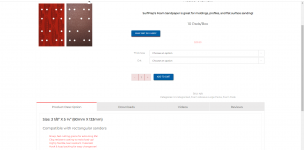

Hi, if in the u.s,surfprep has what your looking for they are excellent for moldings the 1/2 in.foam
