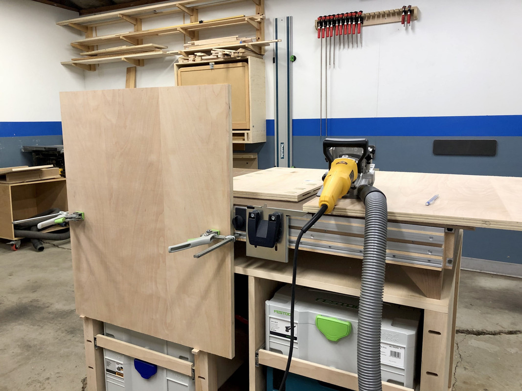

The main thing that comes to mind is simply storage. Just consider what you would want to put in it. For example you could build in compartments for larger items like a small compressor, dust extractor, power strip, etc. Or whatever else would be commonly used at the bench.
Small clamp storage (like the Festool quick clamps).
Shallow drawer for marking and measuring tools, bench dogs, etc.

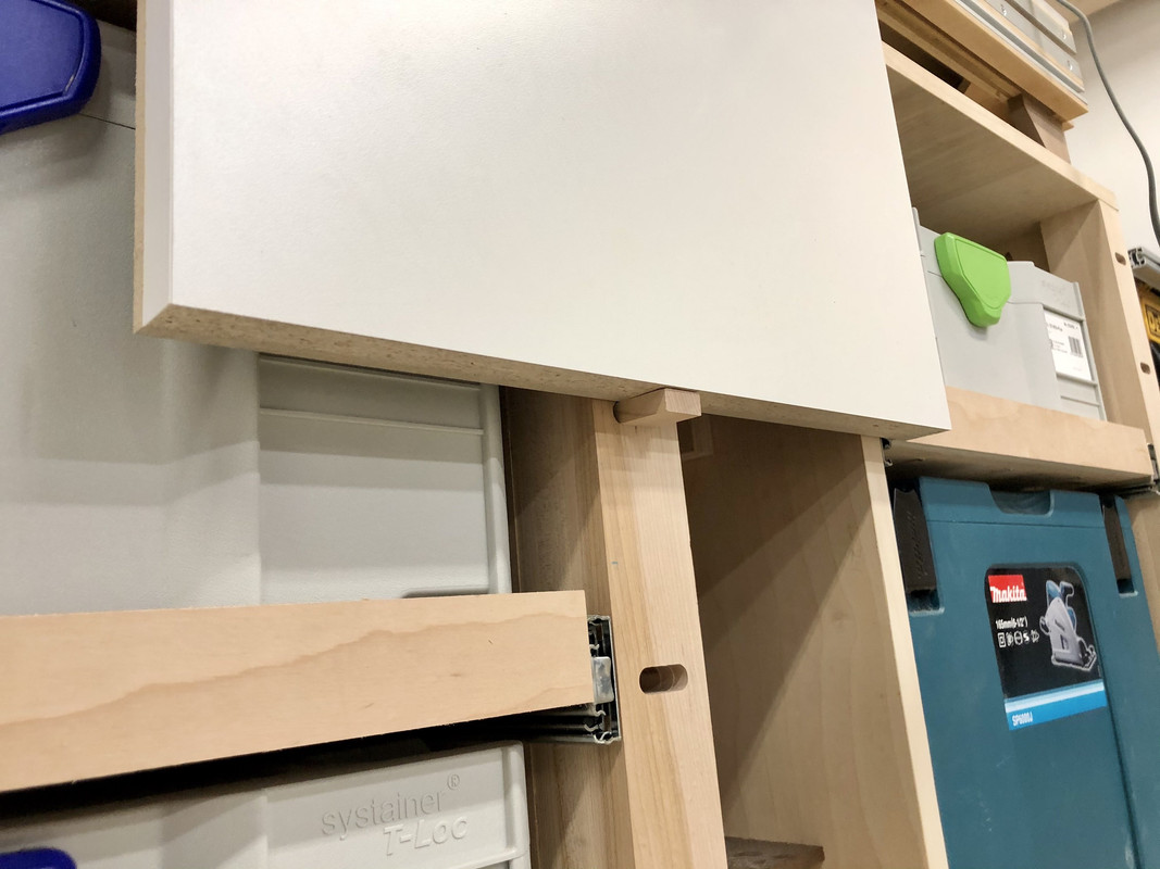

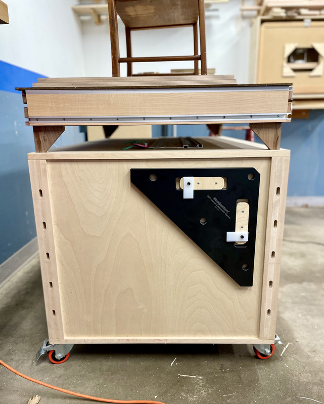

I did a mortise and peg system in the legs of mine, like Timothy Wilmots, to aid in vertical clamping but you could also do T-rack.
And have my Woodpecker MFT square stored on the side.
