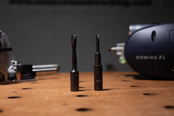

I thought that there was another company also making the Seneca style adapters for the DF700 to use the DF500 cutters. The problem with the adapter is it is a simple looking part to make and people assume it should not cost much to make. When in reality, it is a very precise part , and alot goes into making them correct. I know, I made my own. It is all about the absolute squareness of the end faces, and the concentricity of the 2 reference diameters. The end that fits the DF700, then the end that fits the DF500 cutters. As well as that, it needs to balance very well, or else it will damage bearings in the machine. When all made correctly, and the cutter mounted, it will still cut the correct width mortice. The length of the mortice will be slightly less, as the DF700 has a slightly narrower left right movement amount, compared to that of the DF500. The Domino's still fit ok, just little bit tighter to go in the holes.

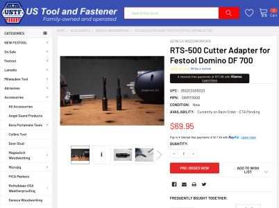

That's a strange turn of events...even the Seneca dealers are sold out. The USTF website asks you to pre-order the item? :rolleyes::rolleyes:
