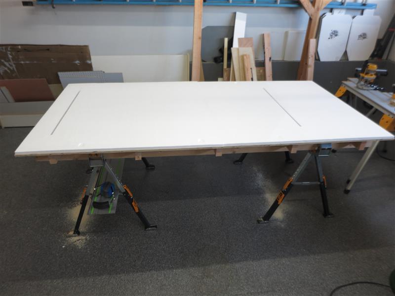

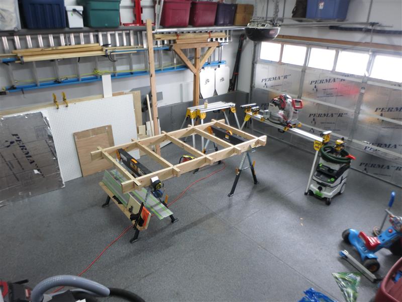

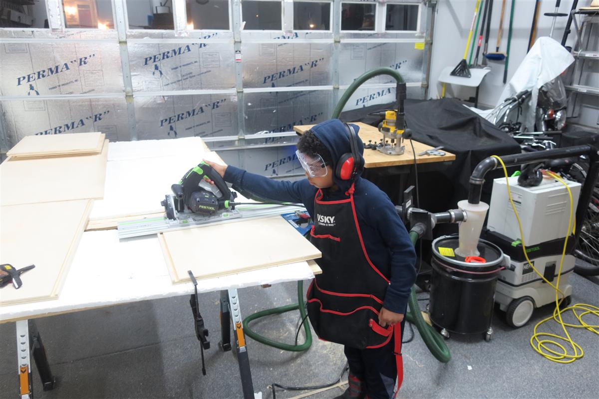

Because nearly every tool I own needs to be rolled somewhere when my wife wants to park in the garage, I made a knock-down 4x8 cutting table out of 2x material.  When I needed a bigger table, I just put pieces of cheap plywood on it and screwed them into place.  In that sense, it does everything I want and then some.  However, when it does come time to replace this, I won't go 4x8 again.  It's too wide.  Awkward for clamping material that isn't full length or width.  Takes up a lot of space.  I don't have experience using two smaller tables, but I have been contemplating moving to that approach with some miter stands.
Anyways, the current set-up I've been using for the last 5 or 6 years:
You can get a feel for the limitations I describe when watching my son helping me cut short parts for his desk. This is what prompted me to switch to a sacrificial holey system as a replacement.

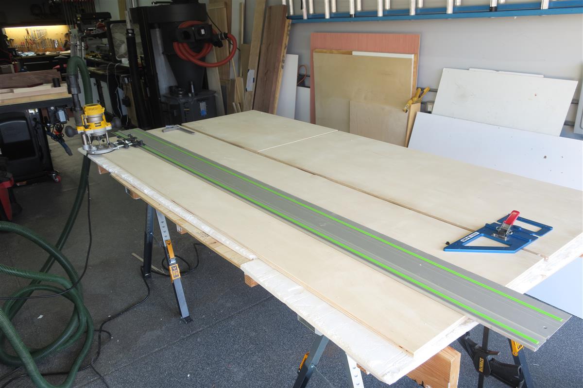

I am making a 5X9 Table made out of three 3X5 tops.  I still have to drill the 20mm holes.  This will allow me to use dogs to keep everything perfectly square.  I've been wanting to make it for a while and the new toughbuilt sawhorses are perfect as you can set it low for cutting and high for working.  It is self squaring once you install all three tops.
