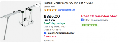

I also adapted the Kapex to fit the Milwaukee contractors stand, which is similar to the DeWalt unit and that works well. It provides a platform to store pencils, a tape measure, a small square, material hold down clamps, zero clearance inserts and various adjustment/service tools.
However, I'm going to order the UG cart and wings to make moving the Kapex even easier.

Thanks to everyone who has taken time out to reply - I really appreciate it. The only way I'm ever going to find out if this saw's the one for me (and if the dust collection is as good an improvement as I'm hoping for) is to bite the bullet and spend time with it. I've ordered a Kapex from ProTrade (thanks Andy [member=71113]Willy Eckerslike[/member]) and I'm picking it up on Wednesday.
Festool in the UK don't offer the 30-day return guarantee, but they do offer 14 days which is more than enough. The reality is that I'll know within a few hours it's hitting the spot, and if dust collection quality (my main reason for considering the change as I explained in my initial post) is worth close to £1500. I'm sure that if this most-important-box-of-all gets ticked, the rest of the machine's features will quickly show their value as well. The handle is a concern having briefly tried one out - but I'll get used to it, all as part of the learning curve. The saw's price doesn't concern me in the slightest - it's all about the performance. It's a commodity being used to earn a living and to get the best possible results from. Although that I'll freely admit that this raised an eyebrow  [eek] [eek] [eek] [eek] [eek]
I have nothing to lose, and maybe everything to gain. I'll let you know how I get along with it.
