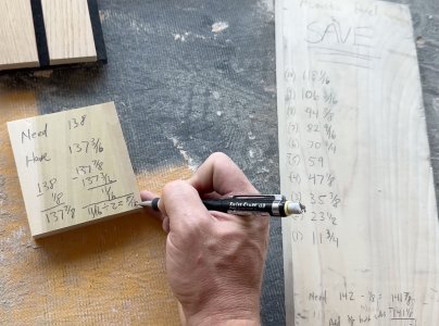

But, then he shows his work:
First up is the fractional math aspect: subtracting 137&3/16" from 137&⅞", which he gets right. But, then he's dividing 11/16" by 2 and getting 5/16" when it's 11/32". He doesn't work to 1/32" tolerances.
My head spun. I am SO glad I gave up imperial measurements! That whole thing becomes dirt simple:
Need: 3505mm (138")
Have: 3484.5mm (137&3/16")
(3505-3484.5)/2 = 10.25mm but it wants to undersize it a tad (he chose 1/16" since that's as tight as he works), so 9mm would be about perfect. And yeah, instead of subtracting the 1/16" from each edge first, since that's him erring on undersize rather than oversize, whether imperial or metric, he should do that at the end, not at the beginning.
Metric, thanks to decimal, wins hands-down every time. And that a mm is finer than 1/16" helps even more without getting crazy on what you can measure/cut by eye.
Ha - I couldn't watch. All those fractions hurt my head. Trying to figure out how to divide 3/8" into anything is just painful and slow. It's the reason why I really made the move to metric in woodworking. Why make it more difficult? One of my friends, who does carpentry work, defends imperial - always trying to tell me dividing fractions "is easy." Of course, he's also the guy that measures six times and still cuts it wrong!
