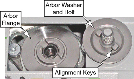

If the tearout is happening on both sides of the blade, you could have runout in the blade. This does not automatically mean runout in the arbor shaft though. Remove the arbor bolt and inspect the arbor flange and arbor washer for dirt or damage. Also inspect the blade plate. When reinstalling the blade, try rotating the arbor washer alignment keys 180 degrees from their previous position. Also, spin the blade to a different position from where it originally was.
