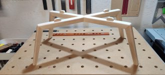

so this is the last thing sanded and I found the 6" ETS wobbly and started to take more off the edges than the middle, but i could have also done with an interface pad on the front of the legs as they are slightly convex.  Is there an interface pad for the DTS to allow slight curves?

No, Festool only has those pads in D77, D90, D120 (125?), D150 (two heights), D215 (225?) and for the RTS.
