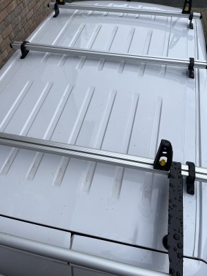

  • Piano hinge with a simple gasket and some kind of hinged lid. I would access the ladder box from the back of the van and the ladders would roll on a rear load roller which you can see in the photo.

Here is a photo of the roof rack:

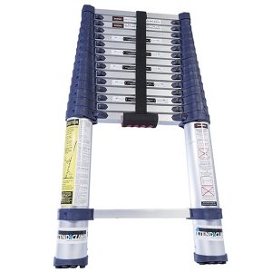

Telescoping ladders are another approach. The one pictured below goes to a claimed 19 feet.

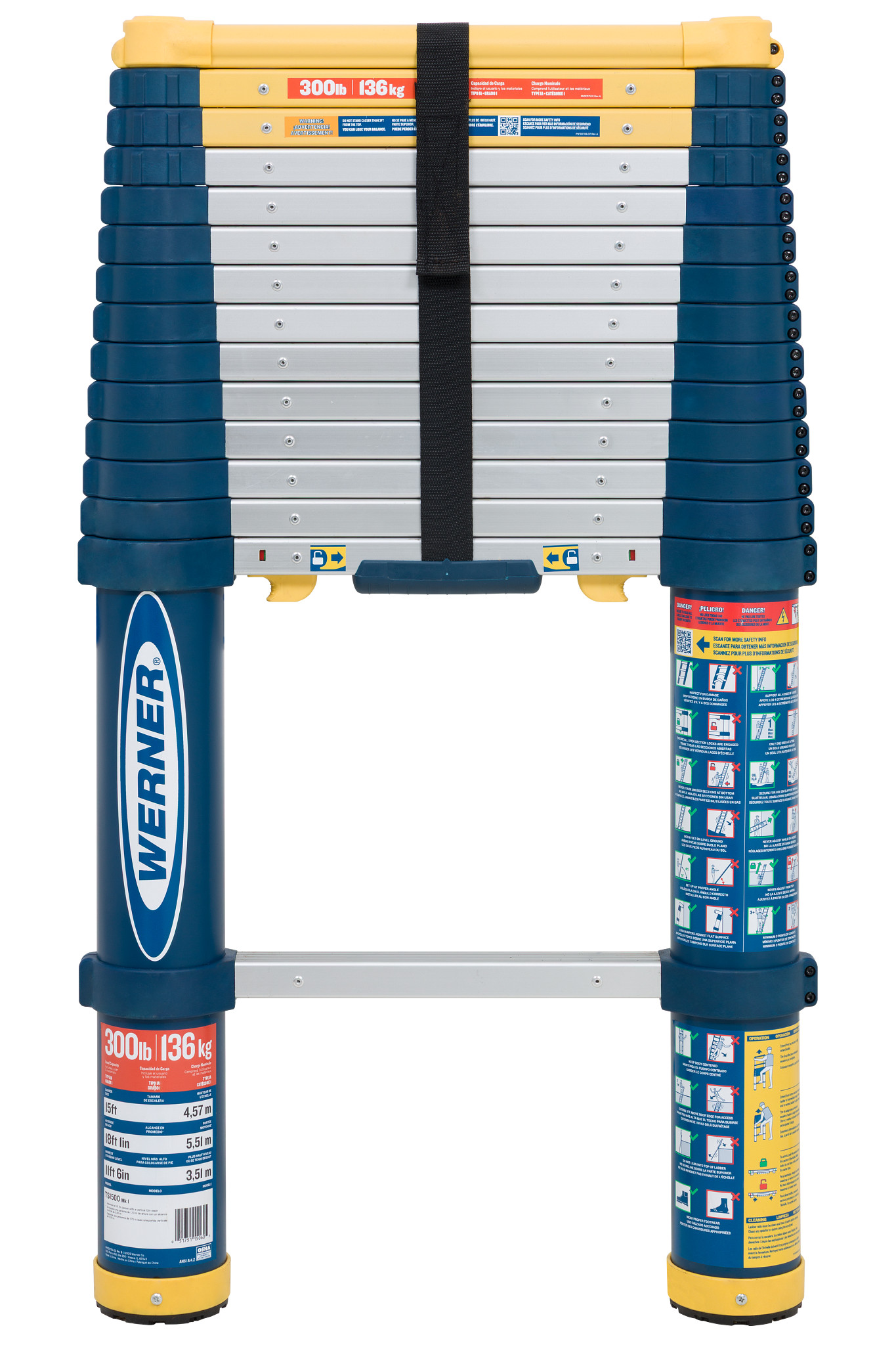

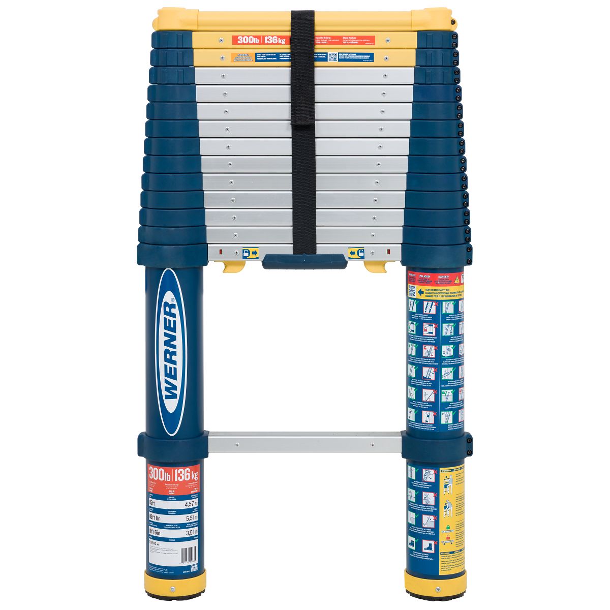

Werner, a traditional ladder producer, now offers a 15’ telescoping ladder rated for 300 pounds. ANSI certified per their site. I have not used that ladder, but have used another. Seemed sturdy while on it.
