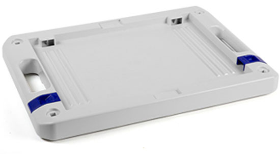

I'm looking for a set of cleats of sort, that I can mount onto my van floor and slide a lock into place to affix a stack of systainers to the van floor, does someone make something like this? I don't really have the space for a full racking system, so I'm just hoping I can secure a stack for transport.
Hoping for something like a SYS-CART base, but without the bulk.
I have both L-track and E-track, but I'm kinda looking at putting it smack dab in the middle of the floor. It'll be the first thing I take out, so being able to secure the stack alone means I won't have a spiderweb of tie downs to deal with.
Just screw/bolt a sys1 to the floor? a Piece of plywood in the base for strength. . ?
I think I've seen someone rip a lid off and screw it into the floor, since it's cheaper than a SYS-CART.
Hoping for something a wee bit more low-profile though.
You could make a ‘docking station’ for the Syscart pretty easily.  Just fashion a side wraparound ledger based plywood dock to capture the outside edges and a dowel slid in across the front - low cost and would do the job easily.

Have you looked at the Milwaukee Packout system? Most all my Festool lives in Systainer's but everything that is less fragile lives in Packout's that are far larger than Systainer's which allows easier organization, meaning I can throw everything into one tool box.

Would you want that mounted in the middle of your van floor? To step on and trip over? Possibly kicking and breaking the blue locking tabs off?
