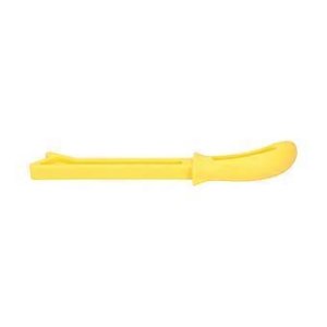

The second accident did not do much damage, but was far scarier. That event predated the “kick-up” accident and I was using a resin push-stick. One of those widely distributed yellow plastic ones.
The problem with these (compared to similar designs made in the shop from wood), is sometimes the blade will catch on the stick and instead of grinding away material, it will grab the plastic, cause it to flex into an arc and then it will shatter explosively. The resin is capable of absorbing a great deal of energy. I got bruised on my forearm, but no blood, and nothing hit my face or eyes.
You do far better making your own from scrap lumber or MDF (my preference).
