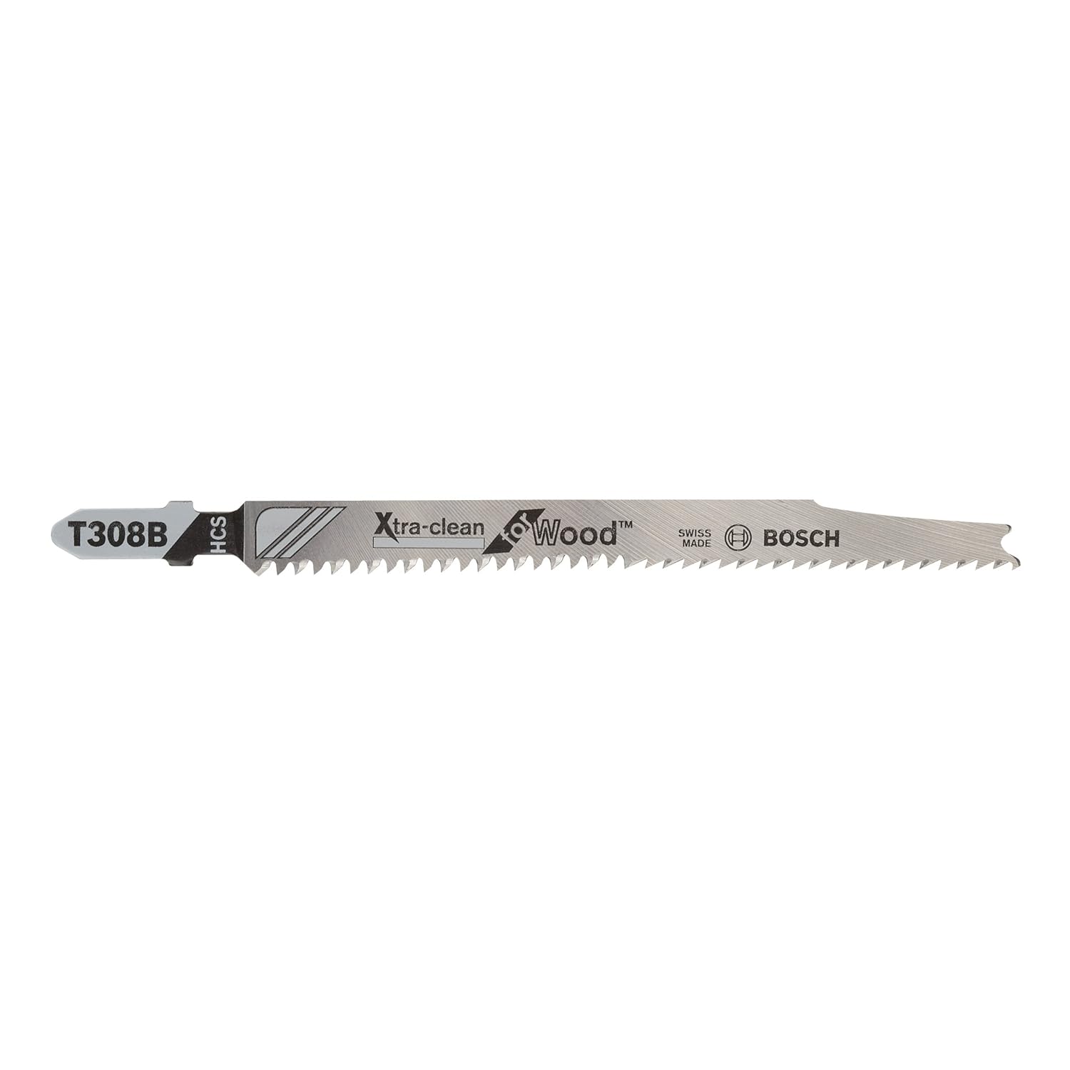

Bosch makes a down cut jig saw blade, that I've used for years with countertops, as it cuts on the down stroke.
Used to use them with a Bosch jig saw, and even my Triton, even though it has the zero clearance insert.
Takes a bit of geting used to, as it wants to push the saw away from the work, but they're ideal for countertops.
