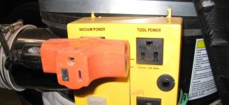

I no longer have the CT26. I used to have this kind (image) on it.
