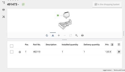

Are these the parts numbers you’re looking for?
Yes that is the one, thank you Frnk! I had a feeling I was looking in the wrong area, why would it ever be on the same schematic as the saw itself?!
