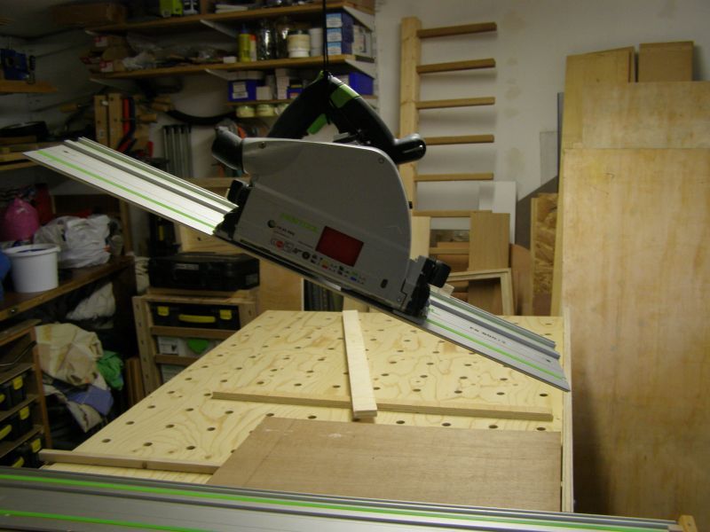

You did a nice job. The biggest clue is that the right end of the guide rail has a sharper focus than the MFT of similar distance to the camera. You could fix that with a little blur on that end. The shadows are pretty close, but the saw was lit from the left and the MFT was lit from the right.
Line on the handle holds the saw, saw holds the track ? ::)
[attachimg=#]
Quite clever but you should have photoshopped the string out of the picture  [tongue]
It is better to use clear mono-filament fish line.
Photo shop has a clone tool that can clone background over the line.

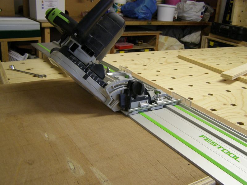

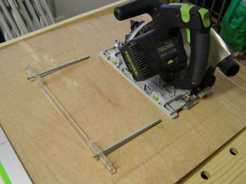

Copcar got close but no cigar. Yes ts55 is been hung by a piece of string but the rail staying on the saw is the conundrum?  [big grin]
No photoshop Rick. [wink]  You'll like this trick Rick.
Like your thinking but nope and no sticky stuff used hear.
And we don't get the anti kick back thingy with ts55 so its not that. [wink]

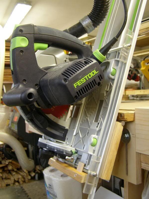

It's a little MK1 jig I made few years ago that i thought I'd better before posting here but never got round to MK2. [embarassed]
I'll let the pics do the talking.
Some uses.

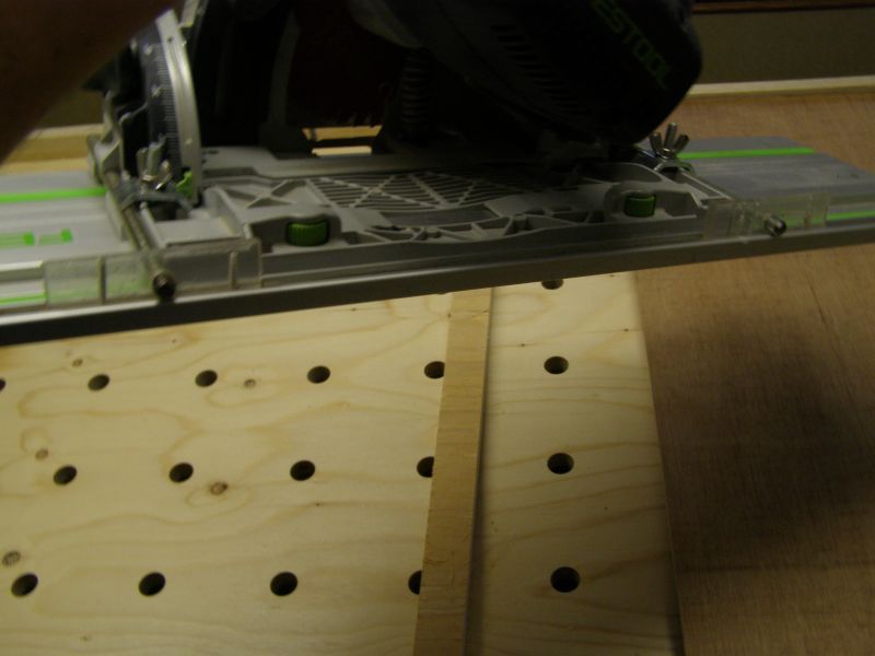

Main use is to keep saw on track when I hinge track up on my version of a mft.

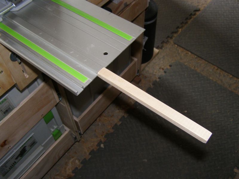

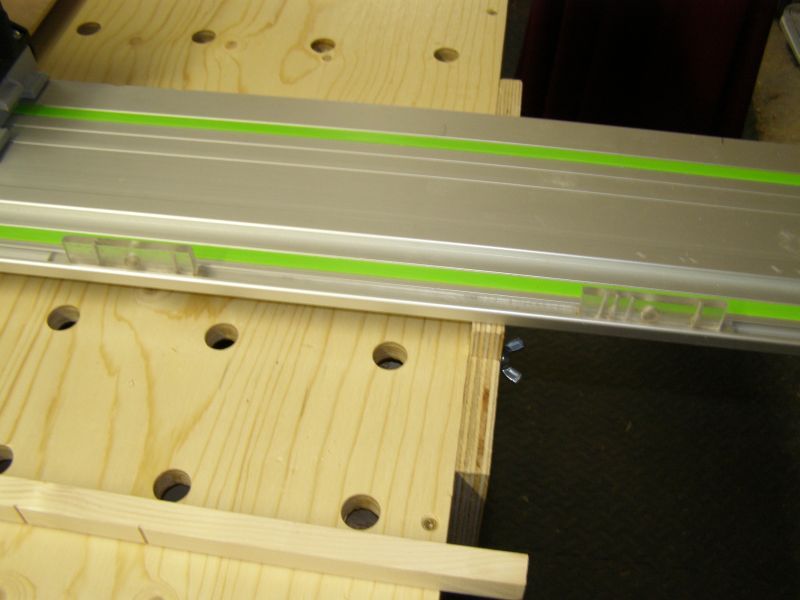

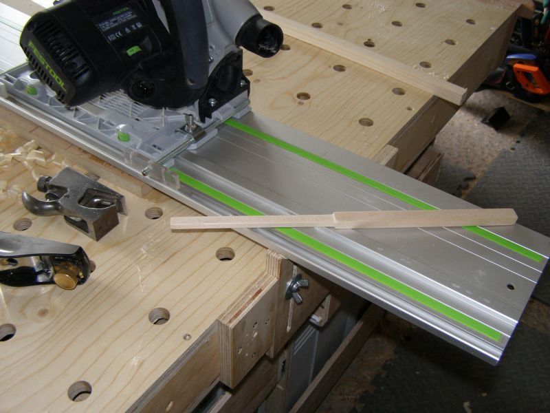

Also doubles as a rail extender to stabilise cuts of end of rail. I'm going to make inserts to extended the slop adjuster rail part.
So simple yet so useful. Hope you guys enjoyed. I'll post some more unrefined ideas/incomplete projects if anyone's interested.

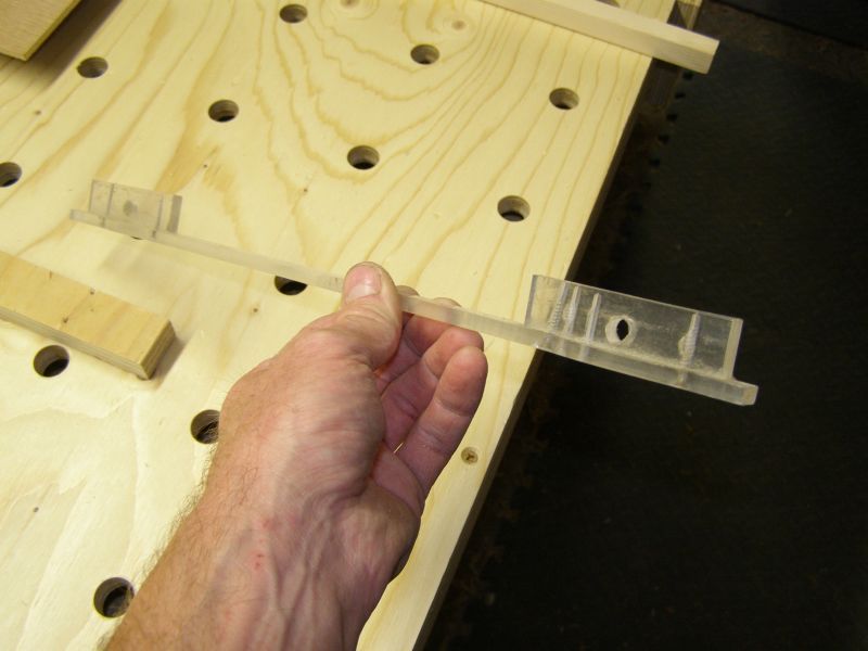

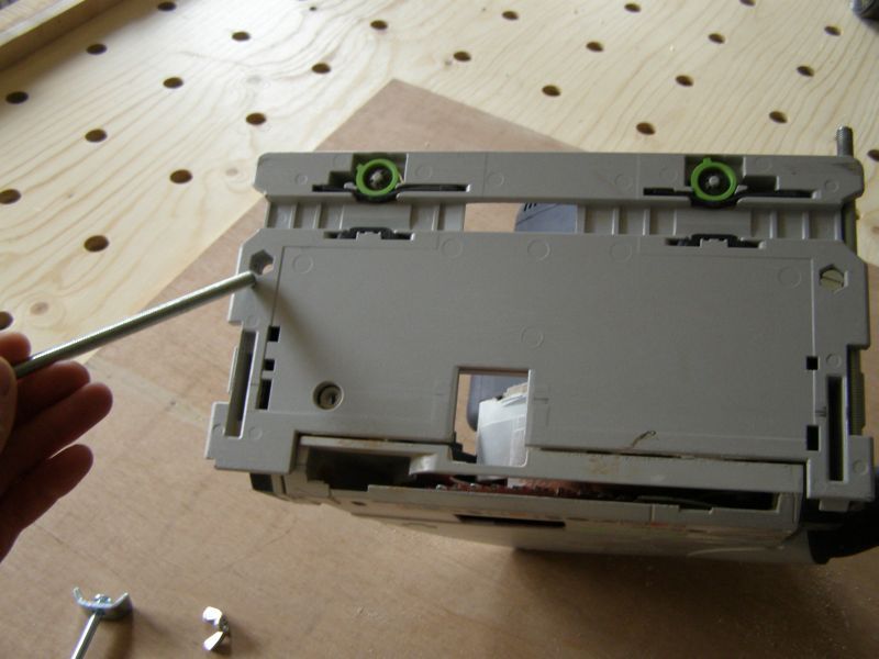

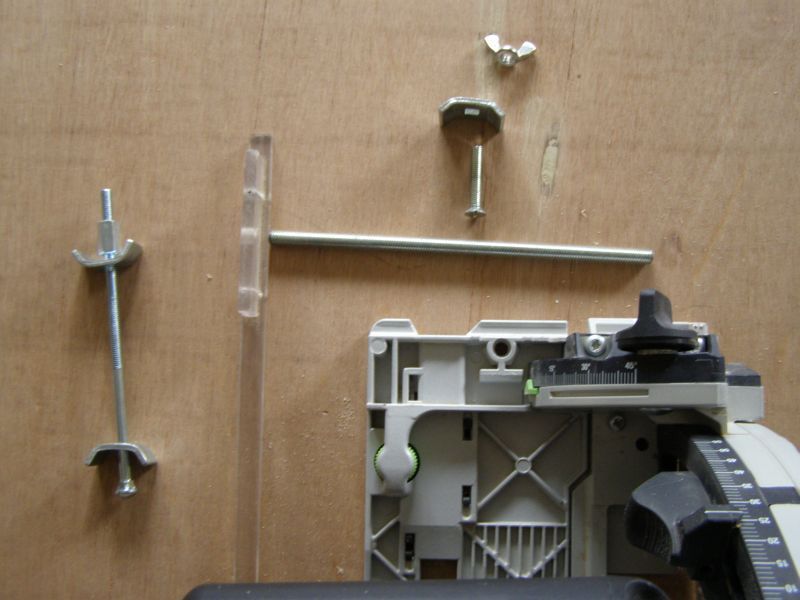

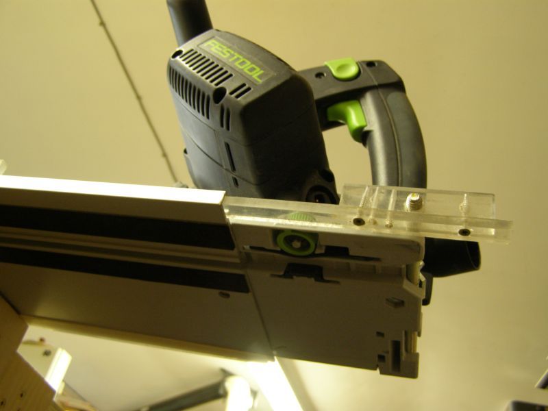

Thanks. Some more pics.

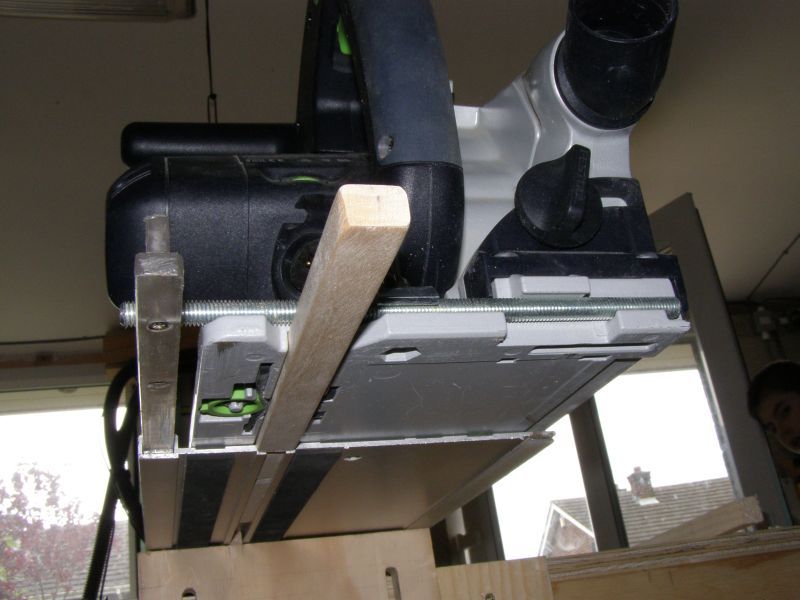

Holes I used are already there in base of ts55 for parallel guide.
Galway. The rails that go onto the saw are 8mm threaded rod 185mm long. I first use to use the 1010 rods but got tired of switching back.
The two screws that go through the ts base are 6mmx30mm countersunk with washer from the counter top joint bolts and a 6mm wing nut. The perspex/polcarb is 6mm stuff that i got off some chaps replacing the bus stop glass.
I've just knocked up MK1 rail extender support.
Do you mind sharing some more information regarding your pivoting mount as well? I am looking at building my own and could use some motivation/influences. ;)

Thanks.
Badtastex i need to find time to remake part of the rail hinge as I've lost the rail attachment bit, think my autistic kid posted them down the mft holes he is defenitly drawn to them. [unsure]
Neilc, the plastic works real good sliding up and down, wouldn't want aluminium on alu sliding. The back extender most defenitly could benift from being alu to stiffen and accuracy.
