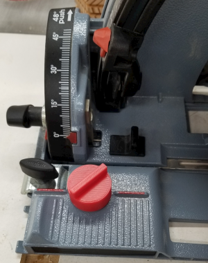

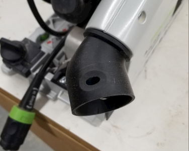

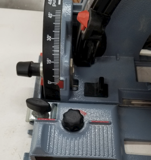

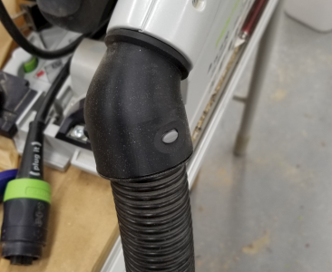

For my TS75, I modeled a dust connector replacement that will accept a Bosch/Centec/Fein style vacuum hose connector. Modeled a similar part for the Mafell MT55 but I can't find the file to post it. I occasionally use the MT55 on Festool rails and find adjusting the track gibs using the original seven lobe knobs extremely difficult. Designed some covers with a rib to provide a little more finger purchase that just slip over the knobs. Friction fit. Thought others might find them useful. STEP files attached.
