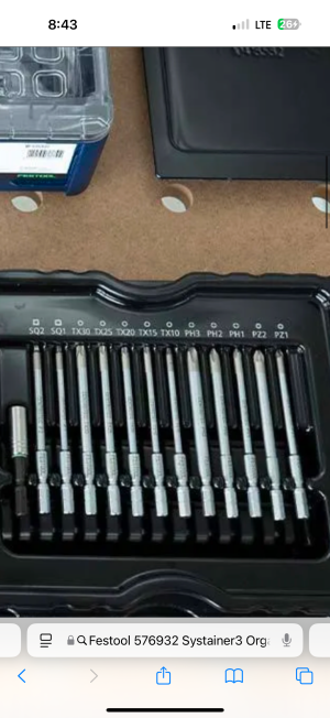

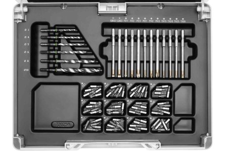

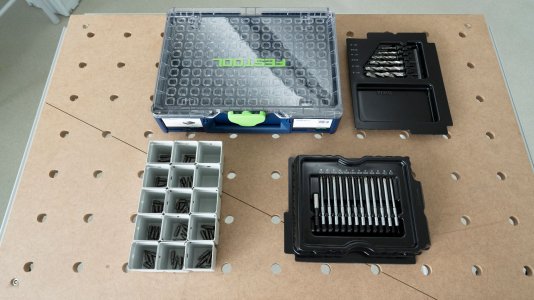

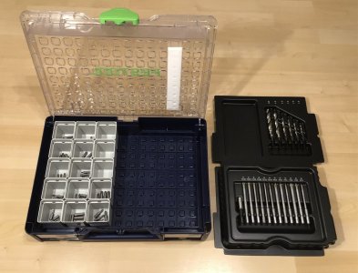

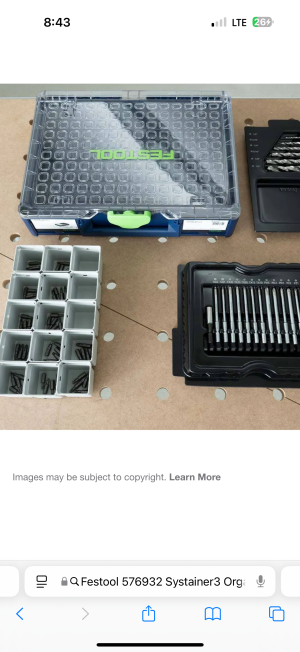

I don't know where you looked, but per Festool description the 100mm bits in that set start at TX 15
Per Coen's post...this is the Torx drive selection in the 576804 SYS3 M 89 ORG CE-SORT.
Further, the only SYS ORGs that I'm aware of that contains a 100mm long TX 10 driver are the 576931 & 576932.
@Coen , do you have any idea why there's such a huge difference in price between the 576931 & 576932?
They're basically the same set with either metric or imperial drill bits. Both are available from Amazon, 576931 for $334 and 576932 for $259.
