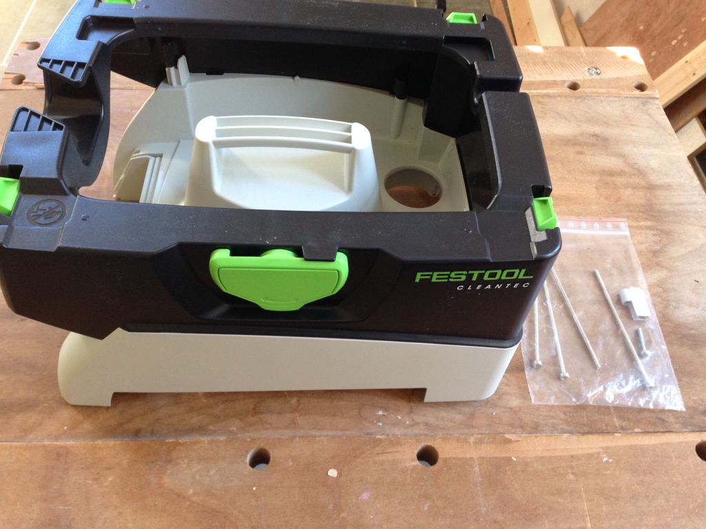

I received my new T-Loc Midi top today and installed it on my CTL Midi from 2008.
Was not as easy as I thought it would be.
You have to disconnect three power wires and the extra earth lead to the hose inlet.
And you need longer screws (supplied also) to finally put everything together.

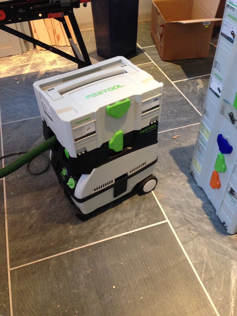

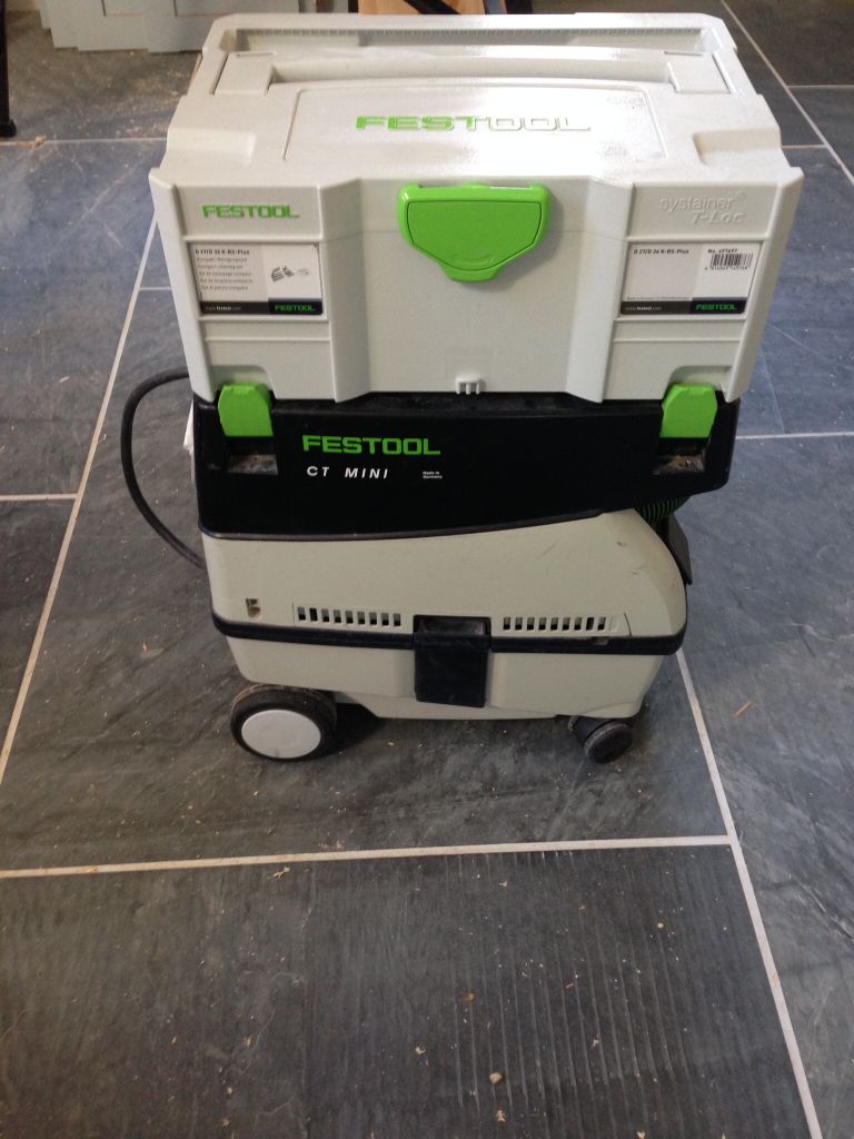

Received my Mini Facelift set from The Netherlands yesterday.
As posted above, it is a little more fiddle than just screwing on the new top, but on the other hand it is a good opportunity to give the machine a good going over and clean.  The only complication which took an extra few minutes was that being a bit stupid, I did not realise at first that the the new screws are provided 'cos they are longer than the old ones ...d'oh!
A couple of pics
In my view a worthwhile upgrade - the T-Loc fitting is so much more satisfying to use (I found the four clips on the old fitting very annoying).
