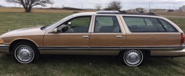

The more stylish option of course is the 95 Buick Roadmaster station wagon.
