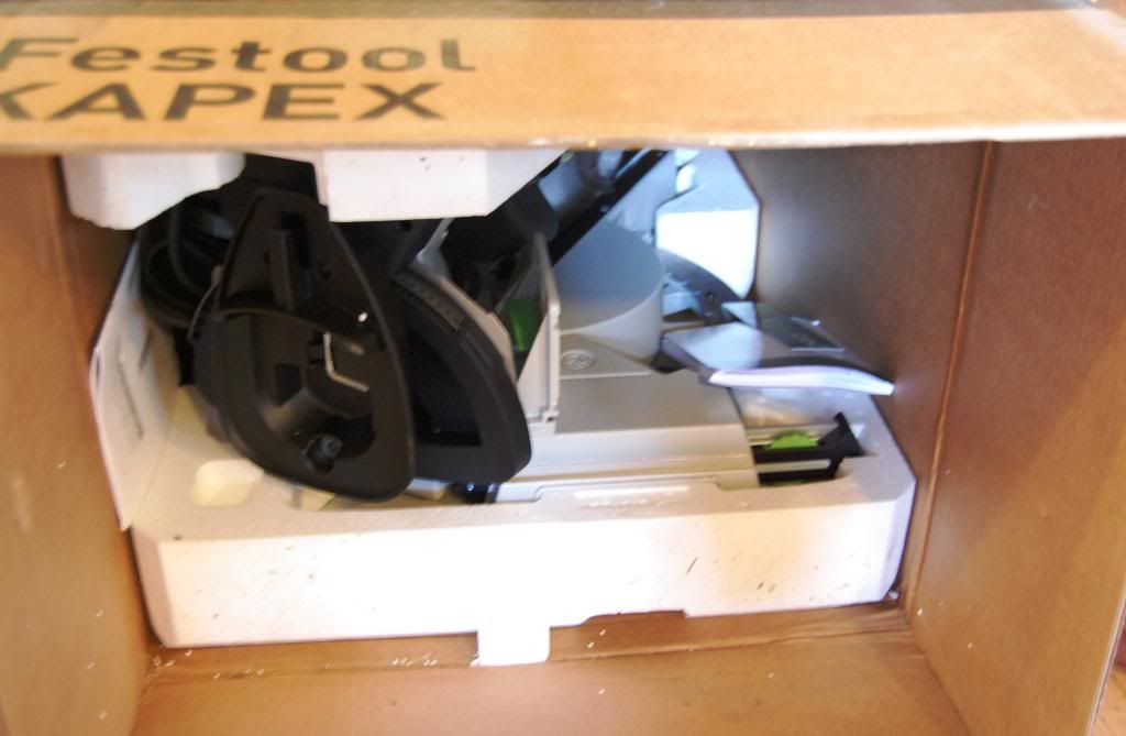

Look what arrived through my door this morning  [big grin]
This should help you decide and push that buy button on the Kapex.

Very nice! [big grin]
